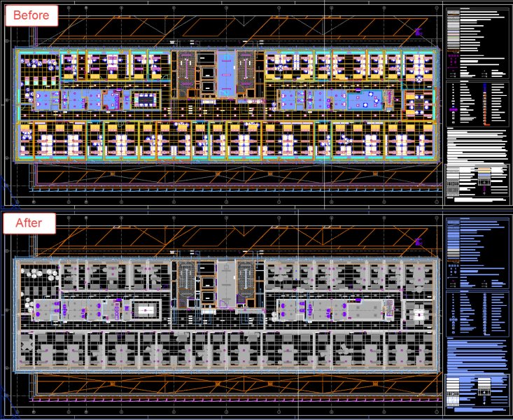

Here is another version it changes some layers, but still suffers from the fact that some layers object colour is white. I used a simple layer test by looking for a line or pline. I was previously trying to be too smart and looking at various objects. I have made the code a load once so no keyboard entry required. I just pasted the lisp from explorer into the dwg. I would normally have it as a menu option.
If you want to force non white then it would require looping through the objects till the colour is not "Bylayer" or white "7" version 2 ? Using the most items for a color is a good idea a big coding overhead as the total number of layers is not that many.

Thanks, I will try it in the evening, because I am currently at work with only AutoCAD LT
Cool ronjonp. I think this is what TS looking for.
Can you make this work with entities within nested blocks?
It should do that already.
I tested it a 2nd time. Did not work when the entity is in block.

Thank you very much.
This work perfect.
I am stisfied.
It would be nice to create layers with color suffix to cover all colors in layer but do not loose the time if it is a big coding.
Give it a try now, I updated the code .. had one line in the wrong loop. :oops:
This work also perfect.

Hi,
it fine increment layer names with the color number but I need also to move coresponding entities to created layers otherwise the result is different as you can see in attached picture.Picture.jpg
Add (vla-put-layer b n) after (vla-put-color lo c).
Brilliant !!!. Your code is short and poverfull.
My admiration :o.
Just small error occurred: "; error: Automation Error. On locked layer"
If I unlock the layers before it work fine.

Hey, I'm in the same situation as OP, but the colors i need set to the layer are truecolors (rgb(x,y,x)).
Any edit to this script to make it work with truecolors?
Tried to google and tinker with the original script, but this is my fist time seeing lisp code and I'm totally lost.

@ronjonp Thanks alot for the quick reply. :)
The colorconversion part is correct. Problem is that the layers have a specified color, while the layers features have a specified rbg-color that is not by layer. I wasn't very specific when bringing this up, so i'll try to specify.
So the goal is to get the color from the features of a layer and then set the layers color to the color fetched from a feature.
In my example the layers color is "white", but it contains features colored as eg: 209,217,174.
I would like the layers color to be 209,217,174.

Give this a try:
(defun c:c2l (/ ad b l ln)
  ;; RJP » 2023-10-02
  (setq ad (vla-get-activedocument (vlax-get-acad-object)))
  (vlax-for x (vla-get-layers ad) (setq l (cons (vla-get-name x) l)))
  (vlax-for a (vla-get-blocks ad)
    (vlax-for b	a
      (if (vl-position (setq ln (vla-get-layer b)) l)
	(progn (entmod (append (entget (tblobjname "layer" ln))
			       (vl-remove-if-not
				 '(lambda (x) (member (car x) '(62 420 430)))
				 (entget (vlax-vla-object->ename b))
	       (setq l (vl-remove ln l))
      (vl-catch-all-apply 'vla-put-color (list b 256))
It works perfectly. Thanks alot! :)
Now if you got any idea how to automatically convert pantone colors into rbg, i'm all ears. :)
