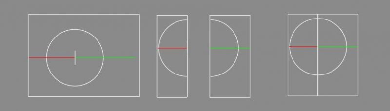

I'm just re-familiarizing myself with AutoCAD after a four year stint as a CNC operator, and I'm trying to remember a little trick I used to know. I would like to clip an image file with multiple polylines as the clipping boundaries. The problem I'm having, however, is that there doesn't seem to be an "all-in-one" solution for this task. XCLIP only handles a single clipping boundary. So I tracked down "XClipM.lsp", which covers multiple clipping boundaries, but not arcs, circles, splines, etc. Then I tried CLIPIT. That handles the arcs and circles, but NOT multiple clipping boundaries.

Thanks for the quick reply. I'm already one step ahead of you (or at least, right there with you) on using the viewports to "clip" or selectively display parts of an image file. Let me be a bit more specific about what I'm trying to do. I'm in the granite countertop industry, and I want to use my CAD drawings to preview slab cutting and vein matching layouts. My countertop pieces will be represented by closed polylines, laid out on imported and scaled photos of the slab to be cut. Multiple pieces can be cut from one slab, and they might need to be moved, arranged, or rotated as necessary to achieve the desired "flow" of the stone's vein pattern. Alternatively, one long span of countertop might exceed the size of one slab, and therefore require a seam. The two halves of the counter must then be cut from two separate slabs, with the positioning arranged to maintain the flow of the pattern across the seam. I had this set up running fairly smoothly for my previous employer a few years back, but I've forgotten nearly everything.
I am basically trying to "mimic" a system called Slabsmith (well, not really, since I think I was doing this with AutoCAD before that product came onto the market). Look up Slabsmith on YouTube so you can see what I'm getting at. There should be several short demo videos.
When I had this AutoCAD based slab layout solution set up before, I wasn't able to preview the resulting seam transitions in "real time" like Slabsmith can. Do you think I could solve that somehow with paper space viewports? Can a closed polyline in model space be "instanced" in paper space, so that whatever I move the model space version over will display in the "instanced" paper space viewport? I would want the countertop-shaped viewports in paper space to remain fixed in position, scale, and rotation, while I move and rotate the model space polyline over the JPEG image to find the desired position on the slab photo.
One other question related to this quest; Is it possible to have a "split screen" layout with one model space pane and one paper space pane? I see model space supports multiple viewports, but only model space viewports...
You can line up two viewports by putting dummy lines in model space picking that intersection point in a layout and moving the mview window. The simplest way to slide two viewports would be pick a point viewport one F8 for ortho use mouse for direction then enter a distance, repeat for viewport 2 then lock again to stop accidental zoom. This could be automated a fair bit.

You are probably aware that you could have two adjoing synchronized paperspace viewports, set to the same scales, and use the VPMAX command in either of them, thus enabling you to see paperspace in on, and modelspace in the other.
Might the "trick" referenced in this article be something along the lines you remember using four+ years ago?
http://howtoautocad.com/clipping-with-multiple-boundaries/

Thanks for the CAD tip. I'll try tooling around with that and let you know how it works out. I'm thinking I need the ability to move my clipped images/counter segments around as objects in model space though, so a simple paper space viewport solution might not be what I'm looking for.

Thanks for the topical reply, ReMark. I have already come across that website, and it is not even close to solving my issue. In all likelihood, I will need a custom, magic lisp. I would like to avoid third party solutions if I can due to the additional cost and complexity of workflow, and I sense that I might be able to persuade CAD to do what I need it to do, given a little time and ingenuity.

What about Lee Mac's Viewport Outline lisp program? It does require the use of a layout though.
http://www.lee-mac.com/vpoutline.html

ReMark, that sounds very much like it might be what I need, or at least it will get me close. I'll download it and give it a try, and I'll let you know how it goes. Thanks a million.

Hi ReMark. I'm playing with that lisp a bit, and it seems to just "drop" a copy of a viewport's shape into model space, and call it a day. Have you used it yourself? I need the created model space polyline to maintain "associativity" with the paper space viewport, so that whatever I move the polyline over in model space is displayed in the corresponding paper space viewport. For example, if I imported a JPEG into model space with the numbers "1...2...3...4...5..." spaced out across the image, I want to move the elliptical (for example) MSpace polyline to enclose the number "1". Now when I view my PSpace elliptical viewport, the "1" is visible. Then I go back to MSpace, and move my ellipse over the "2". Return to PSpace, now the "2" is framed in the elliptical viewport, and so on. The way this lisp seems to work now, I would have to work "backwards", panning in my PSpace elliptical viewport until I see the desired area of the JPEG image in MSpace, then "dropping" the viewport/ellipse onto the JPEG. This is not very intuitive, as you cannot see the outer boundaries of the JPEG through the PSpace viewport as you are trying to position it, and there isn't really any way to see or prevent "overlap" when trying to place two shapes on one image. I'd like to upload the file I'm tinkering around with if anyone thinks they can give me a few pointers. Or maybe I'll just take it up with the lisp creator directly...

Another vp-outline.LSP option I've used for many years. Options to either select the viewport or if you're in a viewport it makes the outline for it.
You should also look at the ALIGNSPACE command in Express Tools for aligning viewports.
