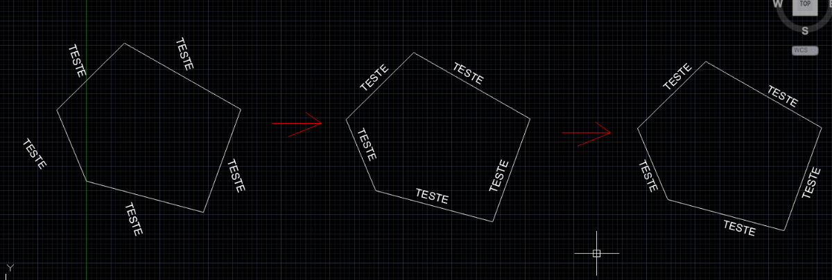

Excellent, it works very well but to be perfect it needs offset.
Felix, I've changed posted code, but like I said : If I was to use this routine, I'd rather tap ENTER and have offset = 0, then to allow CAD to decide what side to offset texts randomly - linear entities can be drawn in both directions - there are no rules here (logic) to be applied to texts last movement direction - some will be translated thoward linear objects and some will be translated away from them...
You are making a MOVE and not OFFSET from LINE.
See how the final position of the texts should be.

OK Felix, I've updated again...
Check it now...
Updated once more... There are rabbit holes here...
I think that now it's covered all like I wanted...
But still offset option is not good approach if routine is to be used IMHO...
Now with OFFSET > 0 it was equal to C:FOO of RONJONP.
It is necessary to analyze the direction (clockwise or counterclockwise) of the LINE or POLYLINE to know if the TEXT or MTEXT is above or below and also the height of the TEXT or MTEXT. That way it will be perfect.

Check it again, Felix...

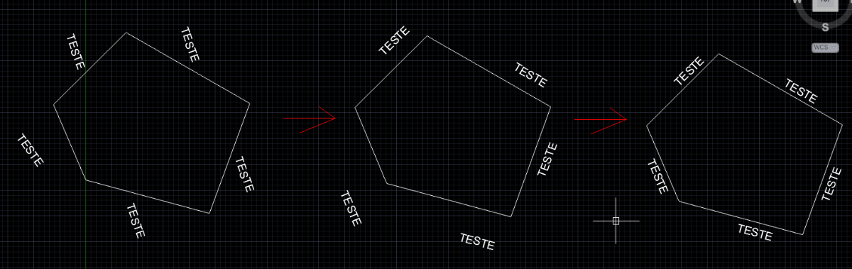

I think that it's not exactly like Ron's version...
My uses mp (boundingbox center) instead of p = (cdr (assoc 10 (entget txtent)))
and at the end it uses (angle (car l) mp) which is different than angle a in a way that it should move texts from lines toward initial mp points, which means toward starting positions of texts... It shouldn't be like middle picture - it should be like final right picture...
OK, I tested it again with more calm and it worked PERFECT, EXCELLENT, it was VERY GOOD, CONGRATULATIONS.
Tested with LINE and TEXTs worked.
Tested with LINE and MTEXTs it worked.
Tested with PLINE and TEXTs worked.
Tested with PLINE and MTEXTs worked.
