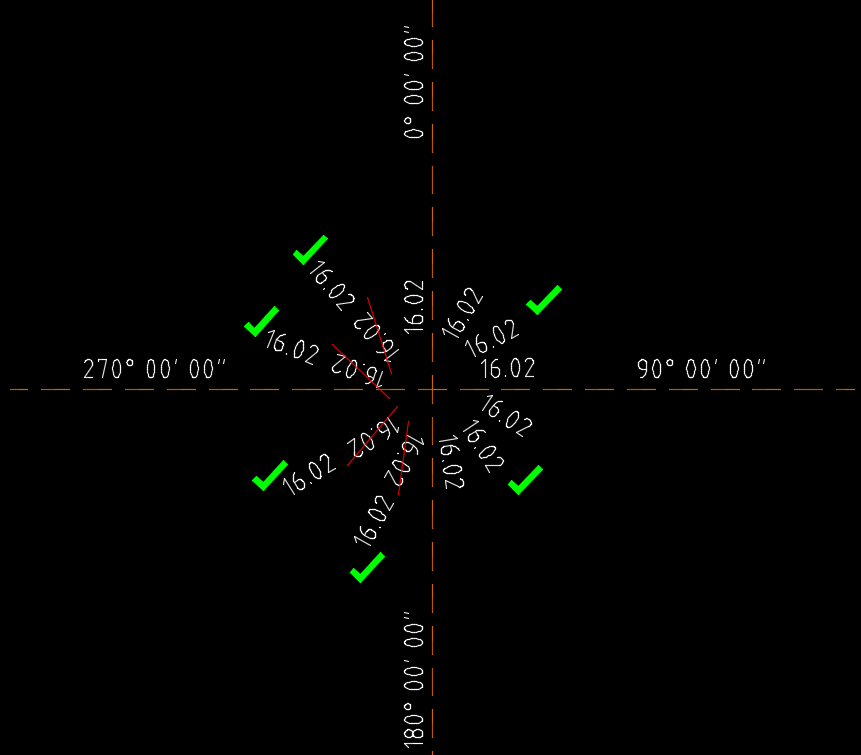

  On 4/5/2020 at 5:29 AM, Jonathan Handojo said:
Initially this post was meant to only rotate the text to the nearest polyline, so this forum is out of your request.
For your case, I modified two lines from ronjonp's code. it should give you the desired result.

Hi Jonathan, these addons to ronjonp's code you made work great. Thanks to both of you. I have no experience with LISP coding, so the question maybe out of the scope of this thread's topic, but many times when i have run your LISP, it returns a "bad DXF group: (50)" error.
IF i only select one text object and one line, it works great. But if i select multiple text objects and multiple lines, the code only works on some or none, and returns the error.
Is there a simple edit i can make to the code to avoid this?
Many thanks in advance.

Try this .. it was bonking out because the _aap function was returning nil.

Ronjop, you are a legend. Worked a treat. Has stopped giving the error message and works selecting multiple lines and text. Some text doesnt rotate on the first go, and seems to work best in small batches, but hey, I'll take that any day of the week and twice on Sundays if it means i dont have to TORIENT each text individually!
Thanks again.

          (setq l (car (vl-sort l '(lambda (a b) (< (cadr a) (cadr b))))))
          ;; Check that we have an angle assigned
          (if (caddr l)
              (setq dxf50
                ((lambda (x)
                   (if (<= (* 0.5 pi) x (* 1.5 pi))
                     (+ x pi)
                     x
                 (caddr l)
              (entupd (cdr (assoc -1 (entmod (subst (cons 50 dxf50) (assoc 50 (setq xx (entget x))) xx)))))
              (vla-getboundingbox (vlax-ename->vla-object x) 'minp 'maxp)
              (mapcar 'set '(minp maxp) (mapcar 'safearray-value (list minp maxp)))
              (setq pp (mapcar '(lambda (a b) (/ (+ a b) 2.0)) minp maxp))
              (vla-move (vlax-ename->vla-object x) (vlax-3d-point pp) (vlax-3d-point mp))
              (vla-move (vlax-ename->vla-object x) (vlax-3d-point mp) (vlax-3d-point (car l)))
              (vla-move (vlax-ename->vla-object x) (vlax-3d-point (car l)) (vlax-3d-point (polar (car l) (angle (car l) mp) d)))
  (vl-cmdf "_.UNDO" "_E")
Edited by marko_ribar
  • Thanks 1
error: malformed list on input
I'm trying to figure out where the parenthesis is missing or left.
At the end.
              (vla-move (vlax-ename->vla-object x) (vlax-3d-point mp) (vlax-3d-point pp))
