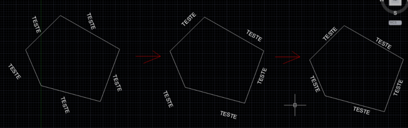

If you can help me again I would appreciate, I tested your code with polyline that have many vertices and the text is aligned with the last two vertices (maybe I wrong), so I tried edit by myself the code.
I thought then that I should take all the vertices and check which ones are closest to the text and it works sometimes, I believe the mistake is that I need to find the shortest distance of two vertices (middle point). my knowledge of lisp is basic, even worse when it comes to mapcar and lambda, if not asking too much could help me make lisp work as  the example below.

It can be modified but really a quick fix for your sample drawing is to explode the polylines then run the code.
  • Thanks 1
Expand
So I will need transform all polylines to lines, run the lisp and back to polylines?
Can you please check what I doing wrong in the code of the lisp, because only 3 text get wrong alignment..

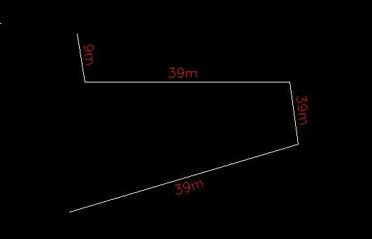

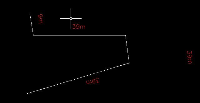

but if i am make the polyline like this, the text become reversed. and then the text didnt move to line or polylines.1.JPG.f5a5ef42a27c2a22decd32d737ea2f4f.JPG
i want to like this, the multiple text will be move to polylines and the rotate follow the alignment polylines.2.JPG.4ac7dceea8bb6aa62fdb9d31aeddf9df.JPG
Expand
Initially this post was meant to only rotate the text to the nearest polyline, so this forum is out of your request.
For your case, I modified two lines from ronjonp's code. it should give you the desired result.

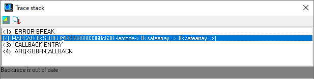

I have the same problem. I have a set of data from sewergems the plan dusplayed is proper but when exported as dxf the texts are missaligned. Im seeking for a lisp code to align the texts at the center of the polyline. Can amybody give me hint??
