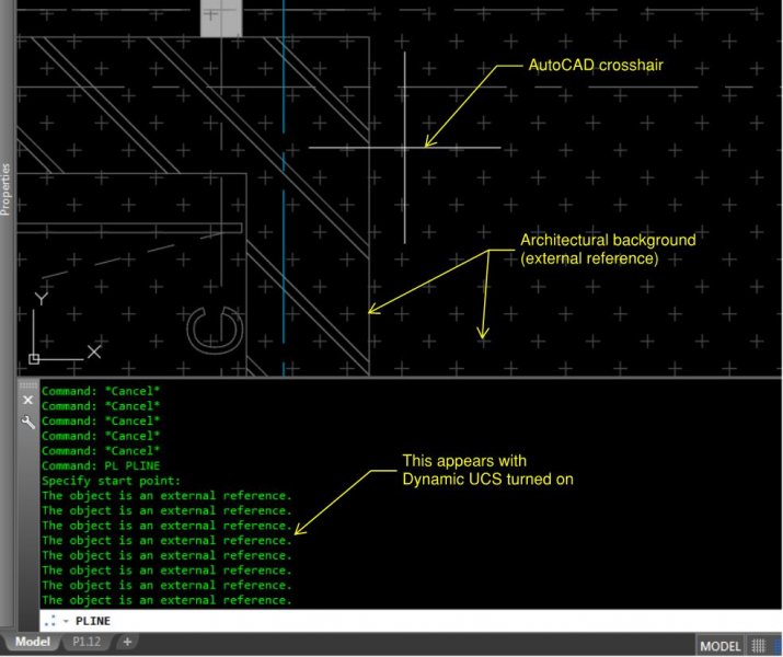

Started running AutoCAD MEP 2018 late last week. A weird message started showing up frequently in my command box. Took me a couple days to sorta work it out.
I noticed that when the Dynamic UCS is turned "ON" and you invoke a command like "circle", "line", "pline" or anything that would snap to an object point then hover your crosshair over an external reference you end up with the following in your command box....
Just thought I would share if anyone has run into to this and is trying to figure out how to turn it off.
