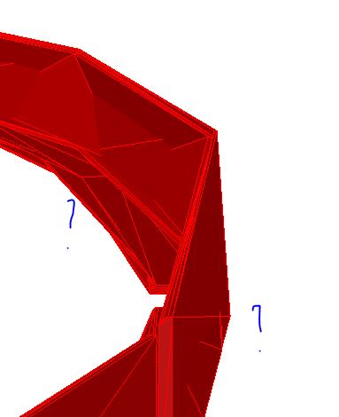

pizarro Posted June 6, 2017 Posted June 6, 2017 Helo, I have many mesh and need convert to solid 3D, the adjunt is a example. Any lisp, visual lisp for this. thank you. MESH TO SOLID.dwgFetching info... Quote
halam Posted June 6, 2017 Posted June 6, 2017 I wonder what you exactly did to get this result? I think these meshes really look awful, my guess this is a exotic import coming from.. to.. via.. what? my advice, (like it or not) Start the modelling proces over in AutoCAD to get something decent. O,.. and welcome here.. No hard feeling, ;-) .. just my reaction .. Quote
pizarro Posted June 7, 2017 Author Posted June 7, 2017 It is just the problem. I use same programs, but don´t achieve a good result. m2s automesher polyhedral mesh to solid mesh to solid (sycode) Quote
halam Posted June 7, 2017 Posted June 7, 2017 What stops you to just model it as solid in the first place? Quote
pizarro Posted June 8, 2017 Author Posted June 8, 2017 The time, the measures are not availables, the the file is only a example. Quote
pizarro Posted June 8, 2017 Author Posted June 8, 2017 The model avaliable is only in Navisworks, it was exported using fbximport to autocad. Quote
halam Posted June 8, 2017 Posted June 8, 2017 Horrible.. I think the best thing you can do is to find the person that can provide you the native designfile. Quote
pizarro Posted June 8, 2017 Author Posted June 8, 2017 I already tried and it was not possible. Quote
