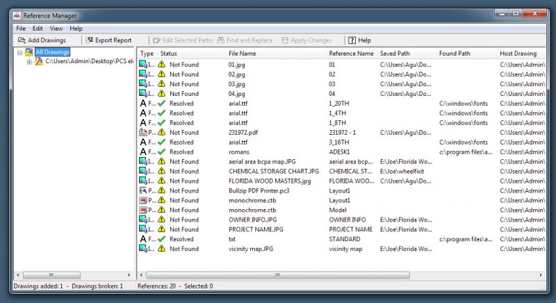

Cad64 Posted June 3, 2017 Posted June 3, 2017 It's interesting that Draftsight can open it but Autocad can't. It shouldn't have anything to do with xrefs though. I open files all the time with missing xrefs and don't get a fatal error. I used the external "Reference Manager" to find out what files are externally referenced in the drawing and it shows 10 jpg image files and 1 pdf file. So I made a dummy folder with 10 random images and a pdf, named them all the same as the missing files, stuck the drawing file in the folder and tried to open it. Still getting a fatal error. Quote

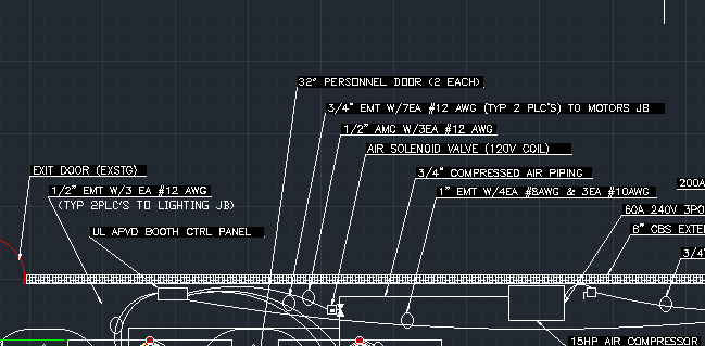

joeatsea Posted June 4, 2017 Author Posted June 4, 2017 Im so confused. Although I had been able to open the drawing I created with Nanocad with Autocad, then work on it and save it. I went back and opened it multiple times yesterday. Today, I could not open it any more in Autocad without a fatal error. I opened it again successfully with Nanocad without any error messages and created a dxf file. Then, opened the dxf file with Autocad and was able to work on it. This would not be important for me to solve if I didn't have dozens of drawings in Nanocad that I need to be able to share with engineers who use Autocad LT and other versions of Autocad. At some point, once I can figure out how to best convert all of them to an Autocad friendly format, I will hav to stop using Nanocad to avoid these difficulties. In this case then, my actiones were. 1. created the drawing using Nanocad and saved it as a dwg file. 2. Opened it in Autocad to find that the text on leaders was not legible and could not be edited (which was the engineer's complaint). 3. Deleted all leaders and text and added new ones on Autocad. 4. Saved as an Autocad LT2013 file (that's the version nobody can open without error messages). 5. Opened the same file with Nanocad without error messages. 6. Saved it from Nanocad as an Autocadv2013 dxf file. 7. Opened it with Autocad without issues and can read, and edit all entities and annotations. Again, I would appreciate it is someone could try opening the dxf file I created of the same drawing using Nanocad to see if it now works with Autocad LT and/or other Autocad versions. I tried to attach it buy it seems to barely exceed the file size limit so I will try to zip it. Quote
joeatsea Posted June 4, 2017 Author Posted June 4, 2017 I tried saving it as a 2004 dwg file and the problem with the text and leaders persists. Autocad shows them as an ACAD_PROXY_ENTITY which cannot be edited or moved. If it wasn't for that, there would be no problem. Quote
joeatsea Posted June 4, 2017 Author Posted June 4, 2017 Here is a screenshot of how the leaders and text shows as opposed to an mtext or note. Quote
