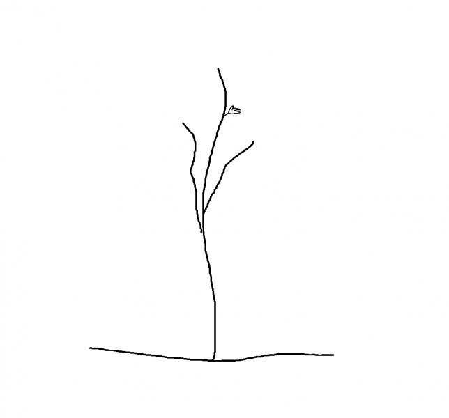

I found a very natural looking tree block once in a dwg by a company that shall remain nameless but has a real big amusement park in Orlando FL. It brought my Video processor to its knees. The block had close to 500 nested "branch" blocks, each with 1000 or so nested leaf blocks made of closed plines. It was an elevation view tree. I tried your technique on it to make it more usable. Exploded, exploded exploded for awhile to get them all, then ran overkill, which erased almost 100,000 overlapping entities. from now on my trees will look like this.:rofl:
We had the same a branch, then blocked, copied then blocked, then copied about 5 times got it down to 1 block versus 4. We could not change its colour trees are green expect in winter for desciduous trees.
:lol
