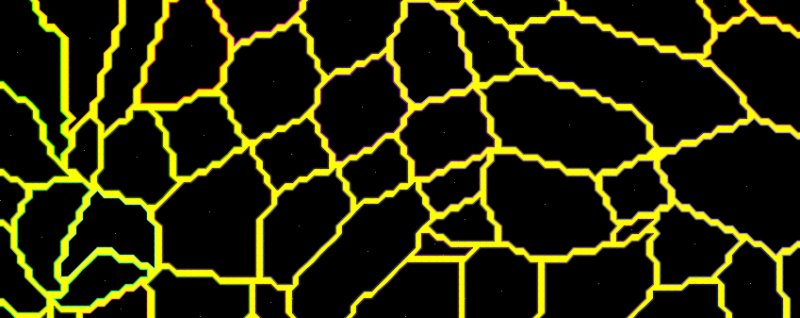

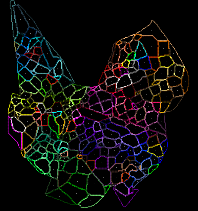

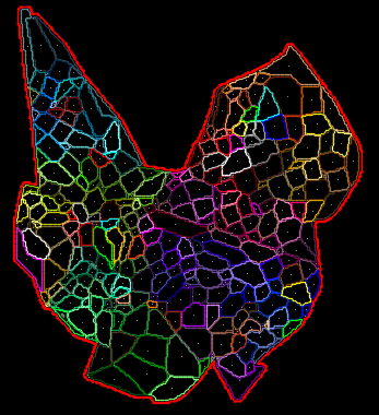

Of course,I came results with the help of Raster design software and buffer in map 3d, but not with great accuracy.
I hope this technology will help me
1:
create polygon topology
2:
create buffer around polygons area
3:
make hatch by pick in area
by Raster Design
4:
create Empty image on area
5:
merge vector to raster
6:
Skeleton new image
7:
convert raster to vector
I admit that, this method is of Ice Age
