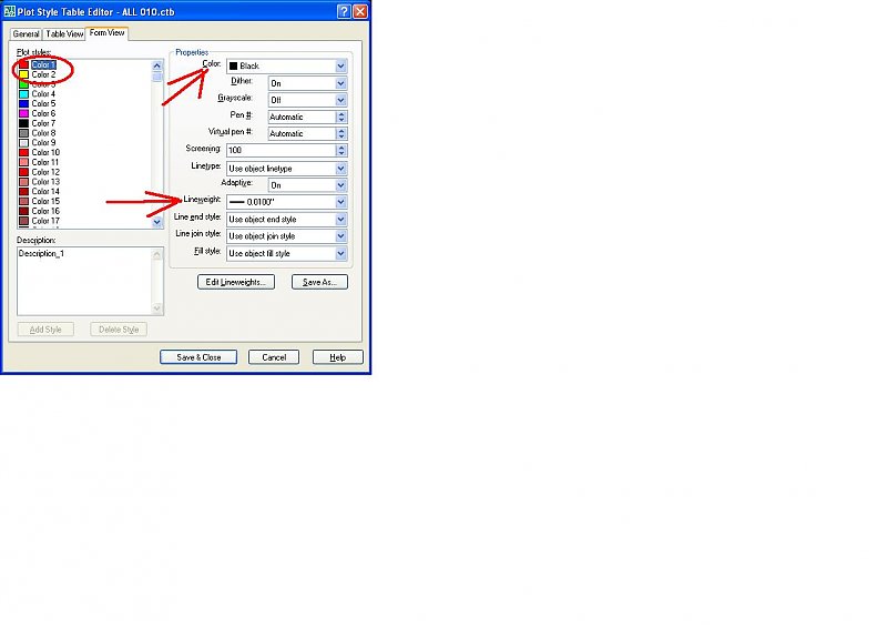

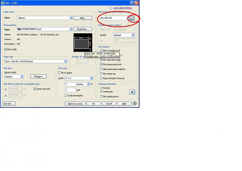

Edit the .ctb you use to print, you can change the line weights per color
