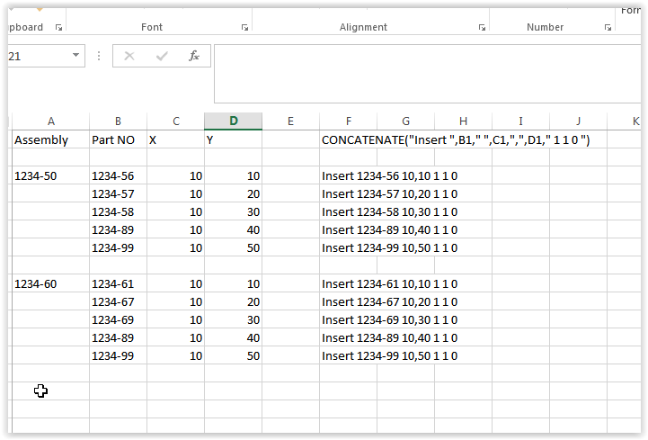

I have done it for you no charge look at this screen dump, yes you could build a way of put in an assembly name and it populates all the part numbers. Just copy column F sections for each part, oops x y for assembly 1234-60 should have a x of say 20. You could just save each group of inserts in a script ie 1234-60.scr then just do just that Script 1234-50
(alert "assembly 1234-50\nloaded by using SCRIPT command")
Insert 1234-56 10,10 1 1 0
Insert 1234-57 10,20 1 1 0
Insert 1234-58 10,30 1 1 0
Insert 1234-89 10,40 1 1 0
Insert 1234-99 10,50 1 1 0
