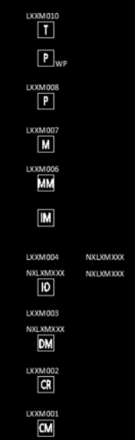

I was wondering if anyone had a fix that might be able to help me.
I am having a problem with this lisp command also.
The command works fine and it addresses/labels my blocks as it should. But I would like to know how I can modify the command to not only address/label the first address/label in my dynamic block but also any other addresses within the block.
For example if I have all pull stations or modules that only have one address that works perfectly. But when I get to my dual modules or IO's that have multiple addresses associated with the block it only recognizes the 1st address (1_address) it will not recognize any other addresses in that block. It will skip to the next block and address it, still in sequence as it should be but then I have to go back and address the other blocks manually.
I have tried to combine 1_ADDRESS,2_ADDRESS, I can not get it to recognize more than one at a time. Even combined it only recognizes one.
can this command recognize multiple addresses within the same block?

Instead of repeating your own message, never very useful, explain what is the relation between 1_ADDRESS and 2_ADDRESS, and how you expect a generic auto-numbering routine to handle this.

The device is a dual monitor module used in fire alarm system design. The block has 2 attributes associated with it. This is because this type of device is programmable to handle to addresses from the panel and monitor more than one point.
1_Address would be the first point being monitored like a tamper switch, 2_Address will be lest say a flow switch. This dual module does the same job as 2 regular monitor modules.
This is why there would be attributes (addresses) 1_ADDRESS and 2_ADDRESS.
I want to be able the auto sequence to recognize that the current block has more than one attribute and label it in order before going to the next device (attribute).
As I stated it will recognize the block but only the address I out in font. If I put it as say 2_ADDRESS, 1_ADDRESS then only address 2 will be counted and address 1 will be skipped and vice versa.
I’m wondering if there is a certain symbol or something that I need to put in between the attributes 1_ADDRESS and  2_ADDRESS to make it recognize both before it goes to the next device.
HEY THANKS AGAIN FOR THE HELP IT IS VERY MUCH APPRECIATED.

When you do a VLA-getattributes you can find out how many so could compare your block and ask for the correct number of values to be entered. If not say to many ask to continue.
If you do say ("ADD1" "ADD2"_ in say a list then pick blocks it will update the 1st 2 attributes if you wanted say 1 & 3 then ("add1" "" "add2") is this what you want ?

The best thing to do is post a dwg so can see what it is your trying to do. Put some text notes in it explaining what is required.
@Tyson904
The program is not designed to do what you want. It is not a matter of changing a few lines, you need a customized version.
I suggest you contact the author (Lee Mac) and take things up with him.

Like Roy once you go past a single attribute it gets complex, the start is to go through a block list and make a list of current max numbers so when add a block it adds 1 to correct attribute . I can see increase att2 but not att1, same att1 not att2. Then we go next request want 3 atts.
Where problems creep in is in deleting a block say in middle numbers and renumber again.
You can make a field of another block att so theoretically can add 1 problem I can think of is block 0 is erased so number + 1 screws up.
Autocad Electrical as I understand has this sort of logic built in so that may be what you need to Google electric patch boards lisp ??
