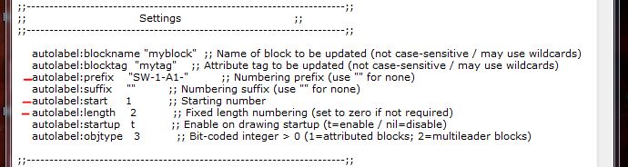

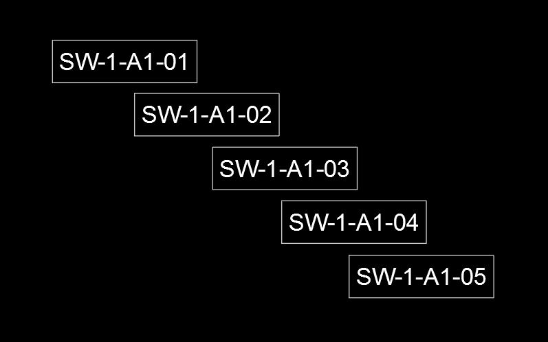

ReMark Posted May 17, 2017 Posted May 17, 2017 Simple steps: follow Lee's instructions. Surely you and three tech engineers can do that if you put your collective minds together. Start with his "MyBlock" and "MyTag" descriptions and make one attribute (name it "MyTag") and one object that the attribute will be combined with to create "MyBlock". Insert the first block then copy it once. The number of the second block should change automatically. As far as the prefix SW-1-A1- make sure it is enclosed in quotes like this "SW-1-A1-". Easy. Quote

ReMark Posted January 11, 2018 Posted January 11, 2018 Let's see a screen shot like the one I included in post #12 of the first eight lines (under the Settings header) of your modified lisp routine. Quote

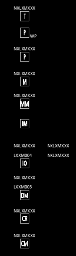

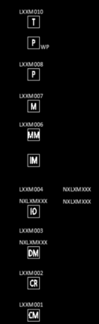

Dohyama Posted January 12, 2018 Posted January 12, 2018 I got it to work maybe, can't copy paste with auto increments in numbering, I have to insert every time. What we have is multiple floors with say 300 to 600 desks per floor. So at times we remove desks, this is no issue as the numbers automatically recount to the end when a number is removed. What we need to do is be able to insert new desks in the mid range numbers. So I need a way where say I have 500 desks but need to insert maybe 5 new desks somewhere around numbers 300-305. This would mean momentarily there would be double entry numbers for 300-305. The program needs to search double entries, keep the newest one and tally the older entries from 306 to the new total which is now 505 seats. Looking at Lee-Mac's vid I thought this was happening but apparently it's not. Quote
