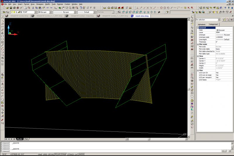

Hello.
I have a polimesh (yellow) that I need to cut with another polimesh (green)
How can I do that?
Thank you.
P.S.
Using AutoCAD 2002
mesh slice.dwg

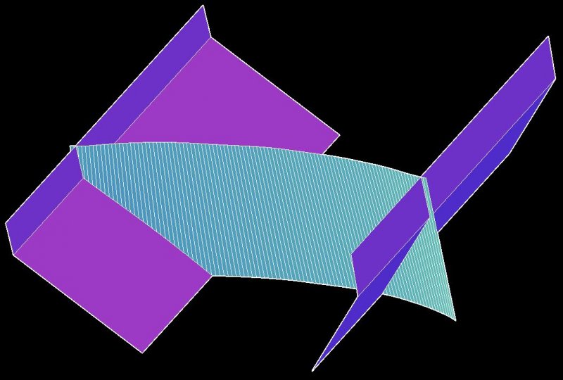

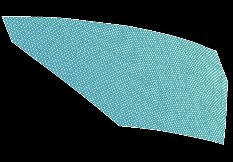

I had no luck slicing your polymesh. I also had no luck converting it to a surface. So I redrew the base geometry using 3Dpolylines which I then lofted to created lofted surfaces at which point I was able to slice the yellow colored object in your drawing. This is the result. It's cyan colored because I drew my new geometry on two different layers with distinctly different colors. Only the result of the slice is depicted.
All three pre-slice objects....
Unfortunately LOFT is not available in ACAD 2002
