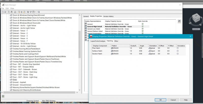

Could you be referring to a surface hatch component in a material definition?
Where did you read this? "I believe Autocad can display a certain pattern based on the assigned Material or certain display parameters of the Mass Element." I would like to read up on this feature. Thanks.

Regarding your question about hatch and Materials please see attached file.
Since you didn't bother to answer either of my questions I guess I'll move on. Good luck solving your problem.
