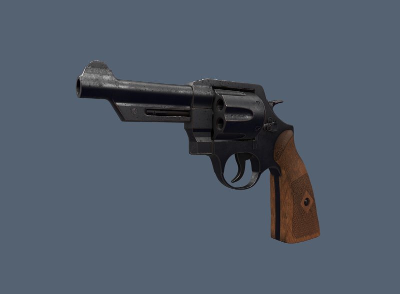

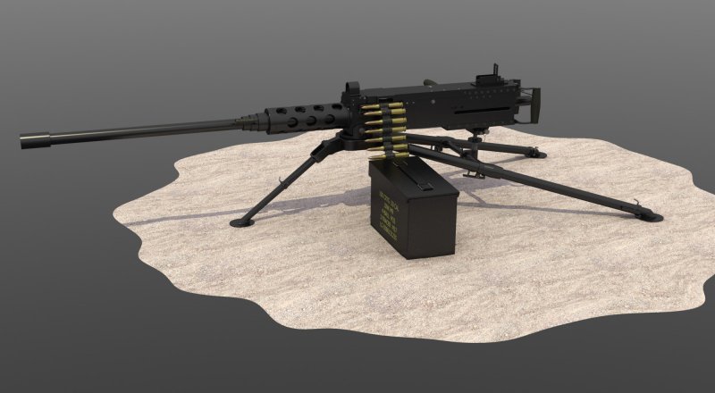

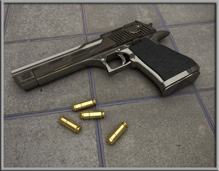

As for accuracy, I created the two handguns below in Studio Max and the 50 cal. machine gun in Modo. They are all dimensionally accurate, based on photo reference. They are high poly models though, not suitable for gaming.
