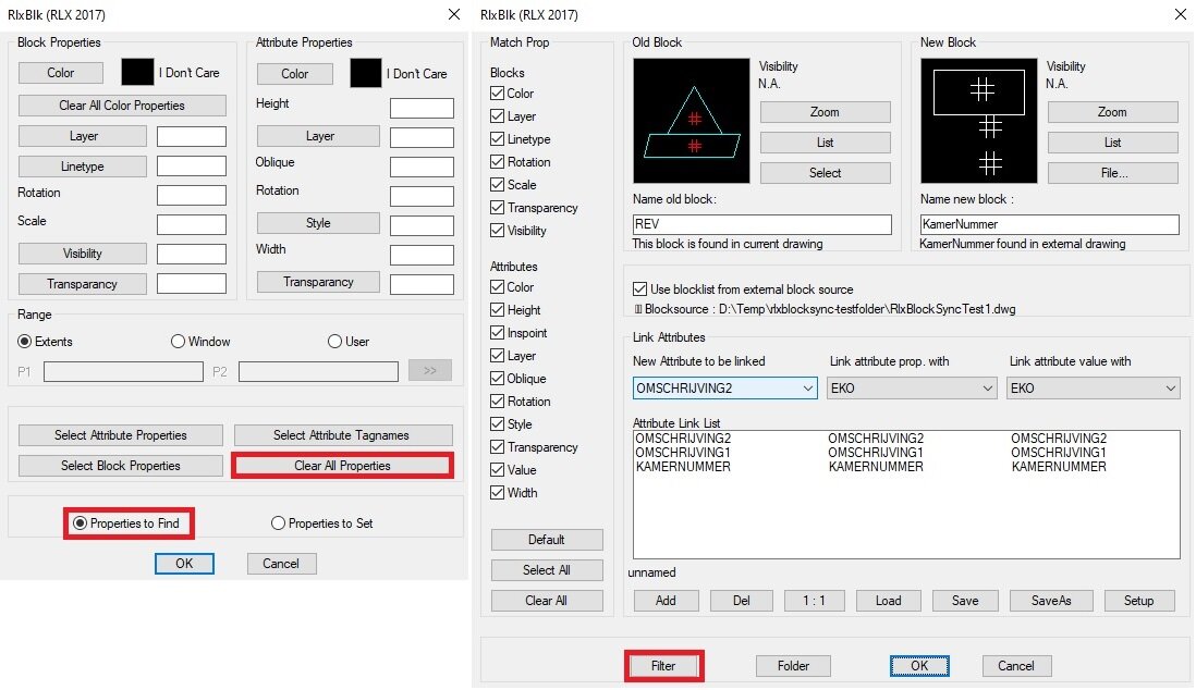

Hi,
Written a tool for replacing (updating) blocks. Had some spare time untill my boss recently used the W-word again (work , yak!)
Anywayz , its a prototype so I'm not sure its stable and safe yet because I only did some lab testing. I hope it will be usefull. Not sure if I will be able to work on it further any time soon because I still have a few ideas and wishes.

I've updated the code in post #1 with transparancy option and cleaned up the filter dialog

Rlx this looks truly amazing, but I end up with this message immediately after running command RLXBLK:
Can you help me understand what am I dooing wrong?
thx
Must admit haven't done anything with this program for a long time , mainly because me , myself & I and my colleagues rarely used it and its a little 'hard to drive' because I went a little over the top with all the options. Problem you're having is probably dcl file isn't in your search / support path so add the folder that holds both lisp and dcl to your support path.

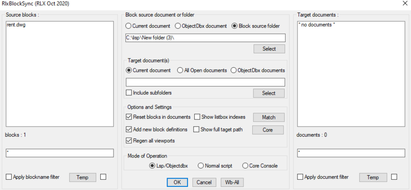

Have been working on what was supposed to be a lighter version (a work in progress) but have so much work that there are just not enough hours in my day's. I will add this lighter version too,  which was originally only meant to be no more than a fancy redefine command like insert blk=c:/mypath/blk but it still need a few finishing touches and I'm not sure how far I've gotten with this one.

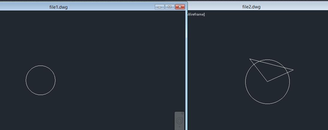

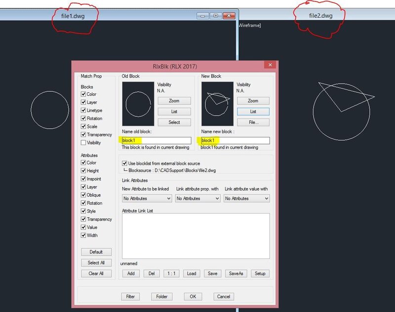

Hi,
Many htanks for all your input on this topic so far. Following your initial advise I managed to run the program.
Unfortunately I was not successful with the expected outcome. I was not able to replace any blocks using external files.
Below you can see screenshots of example I created to test the routine. There are 2x files with one standard block with the same name ('block1') but different geometry. This is as basic as it can be.
In step 1 the program seems running and I can select the files/bocks/properties etc.
After pressing ok, there is no reaction and block1 geometry is not updating.
In addition, there are various error messges in the command line field when I was testing various dynamic blocks with parameters/actions assigned.
Where is the secret to make all this click......
If I remember correctly using dbx the source drawing should be closed , think I never updated RlxBlk to handle both source and target opened at the same time but his should be easy to fix. Another problem was the filter option , default setting wasn't always working as it should and had to make sure to clear props used to select blocks. I sometimes needed option to only update blocks on a certain layer or sometimes with a specific angle etc.
I believe rest of the week every evening there is Darts on tv and the couch patato next to me , sorry I mean my lovely wife likes to watch this (so does my dad when he visits) and I #$ hate it. I rather want to listen to my Bryston / Magnepan stereo 😪 but I can't ...!@#$ Darts! Anyways, maybe spent my time better trying to have a look at the code again. Both apps , rlxblk/blocksync were never created with dynamic blocks high on my priority list , only needed visibility states a couple of times so RlxBlk won't handle any other dynamic prop.
update : had a little test run last night and had no problems , program did what it was suppost to do (making sure source was closed and properties to find were cleared)

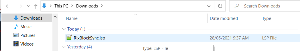

Hello
Can I Get this? the link says its no longer available
  On 5/27/2021 at 5:43 PM, Andrew86 said:
Hello
I just checked all the links in this thread and they all appear to be working.
