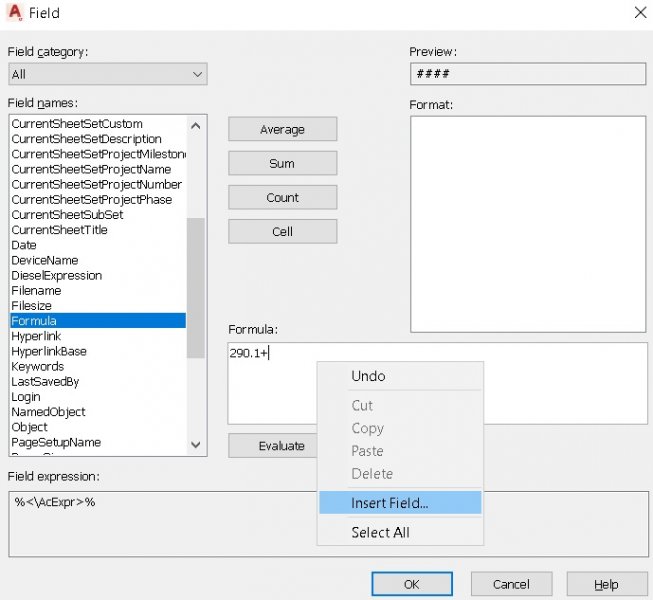

samifox Posted May 8, 2017 Share Posted May 8, 2017 hi using acad 2017, i use fields with object's Y position to read the current level.usualy is a relative level that start with 0.00 now i want to do the same but with absolute level, for example , moving the level symbol and the associated text shows +0.10, i want autocad to add 290.10 to +0.10 reading so the total reading displays + 290.20 not sure how to do it? Thanks in advance S Quote Link to comment Share on other sites More sharing options...
steven-g Posted May 8, 2017 Share Posted May 8, 2017 When you are in the field dialogue, choose formula from the field names section, and in the formula entry box you can place your constant and use right click to enter another field (object). You can add or choose multiple fields within the formula, or diesel expressions so you can also access stored variables. Quote Link to comment Share on other sites More sharing options...

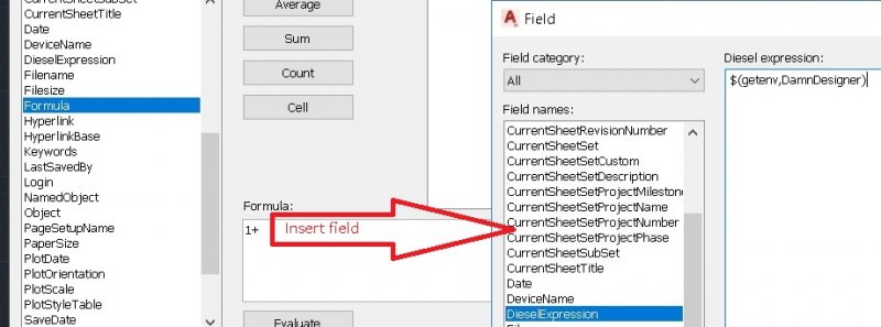

samifox Posted July 11, 2017 Author Share Posted July 11, 2017 hi using formula like 290.10+(-209.57/100) to show an absolute level works great till the designer called to ask to set the 0.00 to 286.60 instead of 290.10. now i had created millions of copies to that field, that mean that i have to go 1 by 1 and to change them, manually? how can i set a variable to hold my absolute value and still be able to use that formula? Quote Link to comment Share on other sites More sharing options...
steven-g Posted July 11, 2017 Share Posted July 11, 2017 You can use a diesel expression in one (or more) of the fields you use in the formula, and then all you need do is change the variable value with the setenv command, and it will update on regen, you might need to alter the Fieldeval variable fieldeval=31 to get the fields to update nicely. Quote Link to comment Share on other sites More sharing options...
samifox Posted July 11, 2017 Author Share Posted July 11, 2017 You can use a diesel expression in one (or more) of the fields you use in the formula, and then all you need do is change the variable value with the setenv command, and it will update on regen, you might need to alter the Fieldeval variable fieldeval=31 to get the fields to update nicely. [ATTACH=CONFIG]61716[/ATTACH] didnt tried it yet but you are the king !!!! thanks Quote Link to comment Share on other sites More sharing options...

steven-g Posted July 12, 2017 Share Posted July 12, 2017 Nope setenv is just a command to set an environmental variable and it is stored in the Windows registry, so it is not saved with the drawing it is the same value for all drawings. Looking a bit more it appears as though the setenv and getenv are unique to LT as command line functions (yeah one up for the LT guys), though it is available to full Autocad through Lisp and probably Diesel. You'll have to test that yourself, aren't there any easy accessible variables in full Autocad? Another method would be to create a custom DWGPROPS value and this also becomes available in the field selection list (and is stored with the drawing) Quote Link to comment Share on other sites More sharing options...
