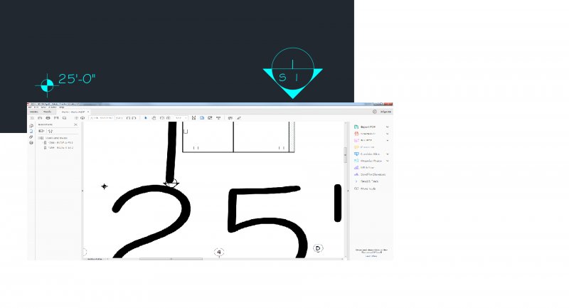

Any updates on this problem? I am now having this problem. Most of my co-workers have had this problem but we're not sure if it started in Autocad 2017 or 2018 (LT). I just switched to '18 and started having the problem. It does not happen with all blocks.
You can see how it is supposed to look on the layout and how it publishes to pdf.
Okay, so just let me throw this out there. AutoCAD and PDFs have always had their issues with each other. This may be fixed with a PDF printer font setting or even a different PDF printer.

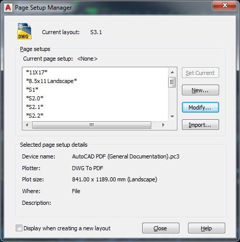

My Page Setups use DWG to PDF
Publish > PDF Preset uses Autocad PDF (General Documentation)
If I switch Publish > PDF Preset to "DWG to PDF" the same problem occurs.
This is from Migrating from 2017 LT to 2018 LT. I've tried to minimize my custom settings to avoid these kinds of issues.
