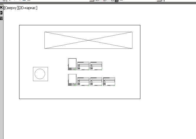

Like this ?
Yeah. Is it a lisp routine? Does it come in English? Would love to give it a try.
If necessary, I can make any language.
This program.
Not Lisp
Written on VB6.
In the .exe archive, the program file.
FileBackup 1.0.zip
Edited by maratovich
This program.
Not Lisp
Written on VB6.
Oh. Thanks but I may have problems install external programes. In my office they disable it. Unless I explain to them. Sad man.
Hope BIGAL lisp works.
Is not necessary installation.
Put it on the desktop, and run it.
