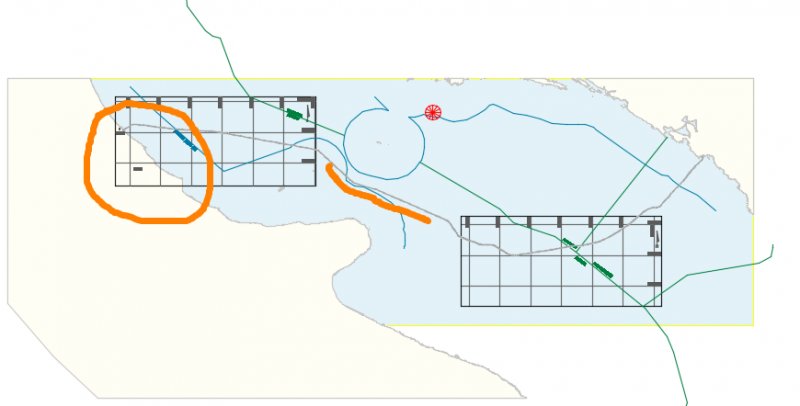

I have this attached DWG and I need to trim everythins so that only the stuff in the grid box will remain. Not that there are some xrefs , and the sea is a hatch, not sure how to trim it.
I'm attaching the DWG.
I tried with xtrim but it didnt work.
any suggestions?
cheers!

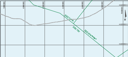

Like this?
If so, I created a rectangle to define the edge of the grid area, so that it could serve as an edge, then I used the TRIM command, which I ran with the ALL option.
After which I just grip stretched the corners of the hatch to fit, no need to trim it. I just copied it for the second one.

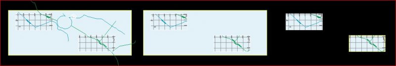

Beaten to the post, Dadgad was too quick - but another option, as I didn't see the xref. You can't trim an xref, or hatches, it depends on the reasoning, but it might better to turn your whole drawing into a block and using the clip command!

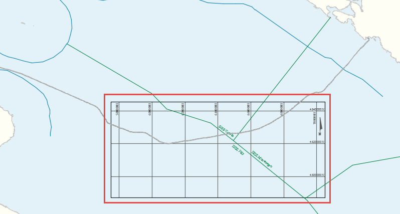

thanks! the only thing is that you also erased the land contours and the gray panels
could you do it again in the same DWG im attaching, but without copying it? could you just keep this original and trim it?

You need to BIND in the Xrefs.
I didn't erase them, they were never displayed because they are not included in the .dwg.
If you bind them in, I will be happy to try it again.
As steven-g mentioned he coud not see them either, for the same reason.
You might want to consider his suggested approach also.

Once the Xrefs are bound, is there really any need to trim those objects, when the desired effect can be created by the edges of paperspace viewports?
