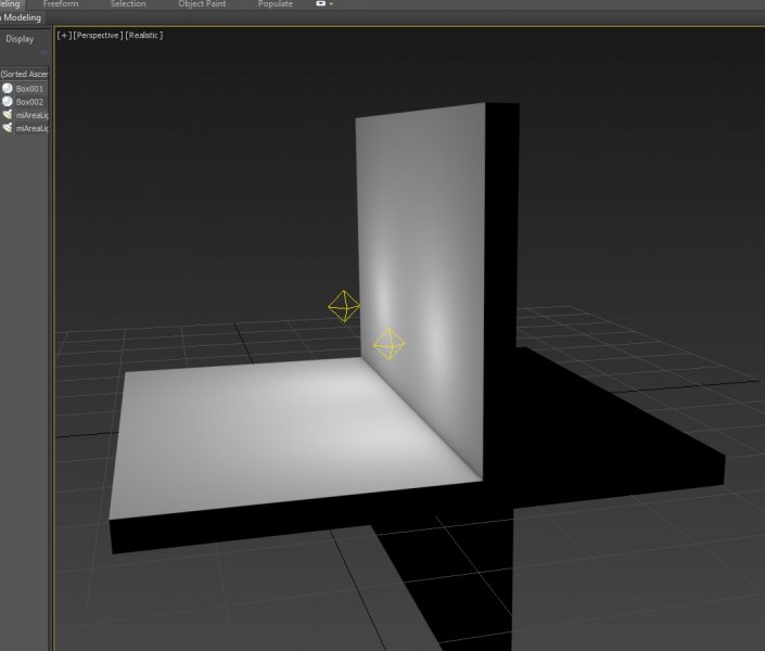

It doesn't really matter what it looks like in the viewport. It's the final rendered image that matters, but having said that, what version of Studio Max are you using? I'm running 2016 and if I set the viewport display to "Realistic" I don't get any light passing through geometry. See below.
