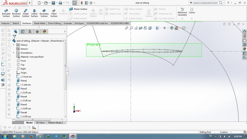

im totally beginner to solid work
at first i must say that may problem wont solve by projection feature in solid-work

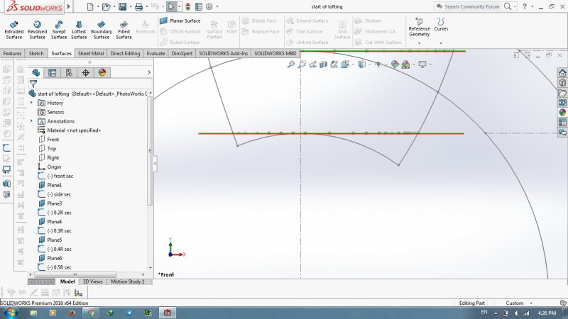

as you can see in the picture witch i attached i have a curve upper and a sector of circle lower
i wanna project the upper curve on the lower one so that the upper curve totally fit on the circle sector
can any body help me with this
Sincerely yours, :)Screenshot - 3_25_2017 , 4_26_30 PM.jpg

poorya, im having trouble understanding what you want to do. Is the inner curve going to be a solid or a surface? Is the curve on a plane or in 3d?
There are a few ways to project curves. From the "Curves" dropdown in either the Feature or Surface tab you can make a Projected Curve that can be a sketch on a sketch or a sketch on a face. The sketches need to not be on parallel planes though. Typically one curve will be perpendicular to another.
There is also a Wrap tool that allows you to Emboss, Deboss or "Scribe". That tool is to be used on solids/surface.
If you can give us some more views or maybe share the file that might help answer the question better.

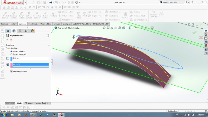

i want to project for example 0.2R sec sketch on front sec sketch
but as you see in the image i attached the result of curve>project curve is not complete
ill be thankful if you help me solve this

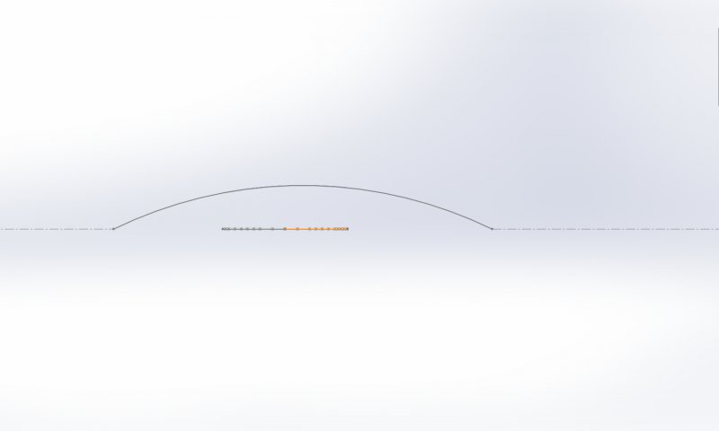

The reason that one is not complete is because your surface isnt wide enough. You are projecting from the sketch plane. If you look at that sketch "normal to" you will see your 0.2 sketch is wider than your surface.
