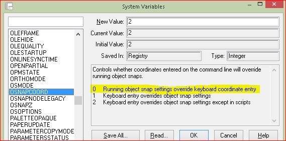

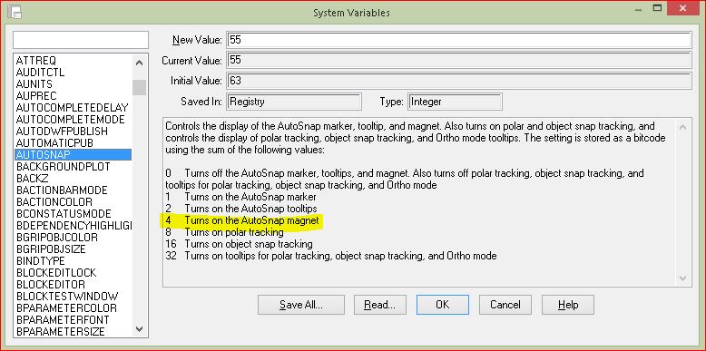

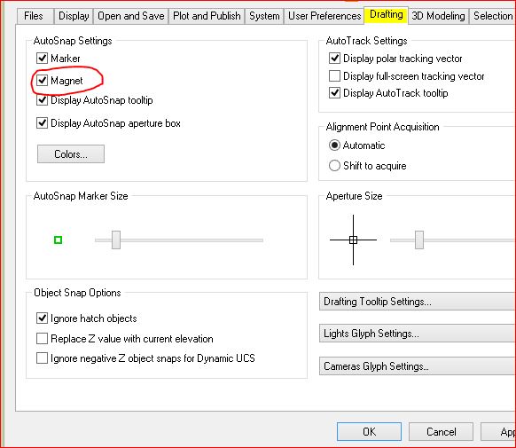

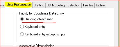

Dadgad Posted April 14, 2017 Posted April 14, 2017 (edited) So for example, I draw a line from the end of another line by snapping to it. I then zoom in to check that the 2 lines have met (are touching) and there is a gap. Sometimes there isnt a gap but most of the time there is.Another example is when i dimension something, i check back and my dimension is inaccurate because the snap points have missed... Sometimes its ok but most of the time its missing. Having just reread your original post, after completing this post, I now see that you are using Draftsite, with which I am not personally familiar. The following information is all from the perspective of using Autocad Vanilla 2013, not sure how much of it will be relevant in your case or not, hope it is. It sounds to me like your OSNAP MAGNET is turned off. This checkbox constitutes one element of the options available in the AUTOSNAP system variable, as shown in the screenshot from the SYSVDLG command. You might want to check your OSNAPCOORD system variable while you are at it. You say that your dimensions sometimes miss the snap, which could be the same as above, or it could be a non-issue, and just because you have turned off the NODE display in your OSNAP dialog box. Edited April 14, 2017 by Dadgad Quote

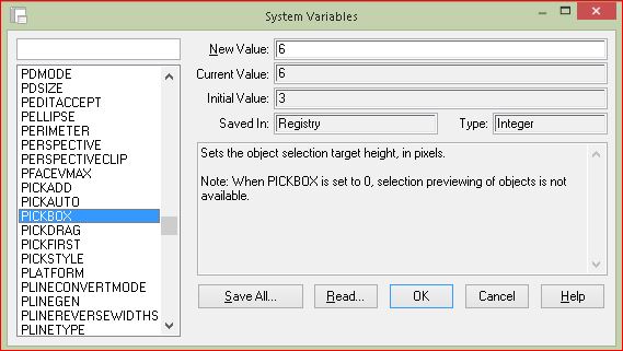

Dadgad Posted April 15, 2017 Posted April 15, 2017 Not if the dimensions are not showing the distance expected, as the OP states. It happens to me, probably because I am almost 70, and have mild RA in my hands, and a bit of CTS too. I can draw accurate geometry all day and still miss now and then with a dimension. I enable object snap tracking, and polar tracking, and display full screen vector lines so I can tell when I am about to miss. If the vector lines start to spin around the cursor, I am missing the snap. I have tried the magnet thingy, but often it grabs the wrong point and has to be slapped into releasing. Is there a way to make the magnet weaker? One has to get used to the fact that the Osnap marker will light up right away, and that is when to click it, not after hesitating for a couple or hundred milliseconds. Snoozin' is losin'. You can't adjust the strength of the magnet, but you can resize the PICKBOX, so that it is smaller, thus reducing the likelihood of erroneously grabbing something close by. This can also be done at the top left of the Selection tab in Options. Quote

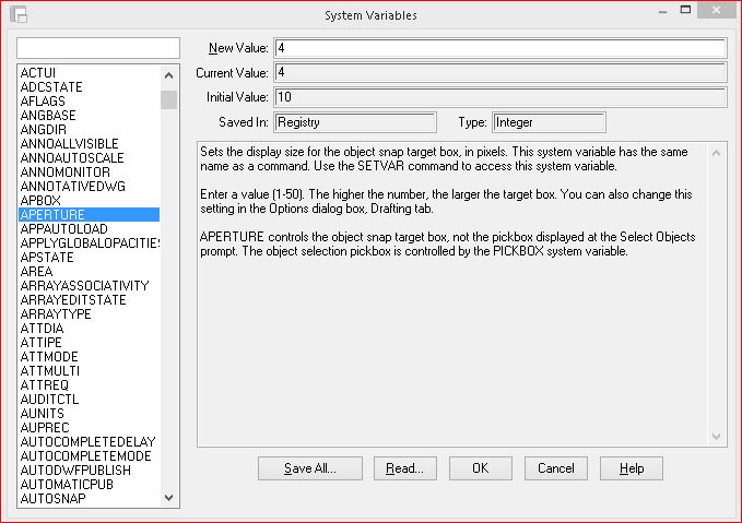

RobDraw Posted April 15, 2017 Posted April 15, 2017 I thought the strength of the magnet was adjustable but a quick search reveals that it isn't, but the APERTURE command may help with click accuracy. https://knowledge.autodesk.com/support/autocad/learn-explore/caas/CloudHelp/cloudhelp/2016/ENU/AutoCAD-Core/files/GUID-C8603032-7E55-4EEF-B2DF-CD2FD9EDEF91-htm.html Quote
Dana W Posted April 15, 2017 Posted April 15, 2017 I thought the strength of the magnet was adjustable but a quick search reveals that it isn't, but the APERTURE command may help with click accuracy. https://knowledge.autodesk.com/support/autocad/learn-explore/caas/CloudHelp/cloudhelp/2016/ENU/AutoCAD-Core/files/GUID-C8603032-7E55-4EEF-B2DF-CD2FD9EDEF91-htm.html Thanks. That does help. (before the drinking. ) Quote
Dadgad Posted April 16, 2017 Posted April 16, 2017 I thought the strength of the magnet was adjustable but a quick search reveals that it isn't, but the APERTURE command may help with click accuracy. https://knowledge.autodesk.com/support/autocad/learn-explore/caas/CloudHelp/cloudhelp/2016/ENU/AutoCAD-Core/files/GUID-C8603032-7E55-4EEF-B2DF-CD2FD9EDEF91-htm.html Right you are Rob, thanks for the correction. The little hover tool tips in Options are a little misleading, APERTURE it is. PICKBOX only controls the display, on, off or size. In the SYSVDLG dialog description of PICKBOX, that isn't really clear. The description of APERTURE there is also a bit misleading, as it says it ... "Sets the display size for the object snap target box, in pixels." If I am working in a really busy or dense drawing, I set my APERTURE size way down, to reduce display of inappropriate snaps. The default value is 10, mine is set at 4 right now. Quote
