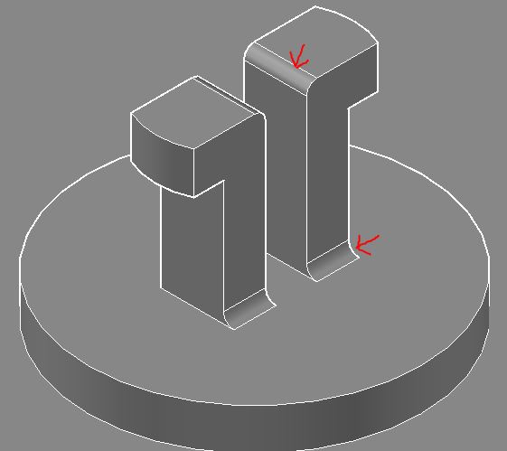

I have made a number of 3D objects by extrusion and connected them via the union command. I would like to add fillets rather than sharp corners at the locations where the objects join (see attached figure). How do I do that?

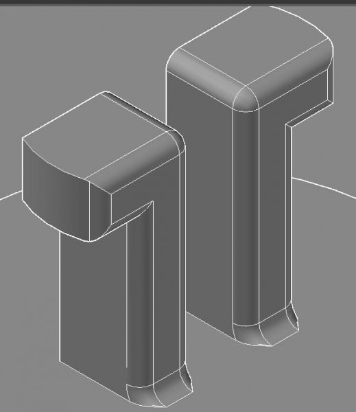

An example roughly based on the image taken from your drawing.
