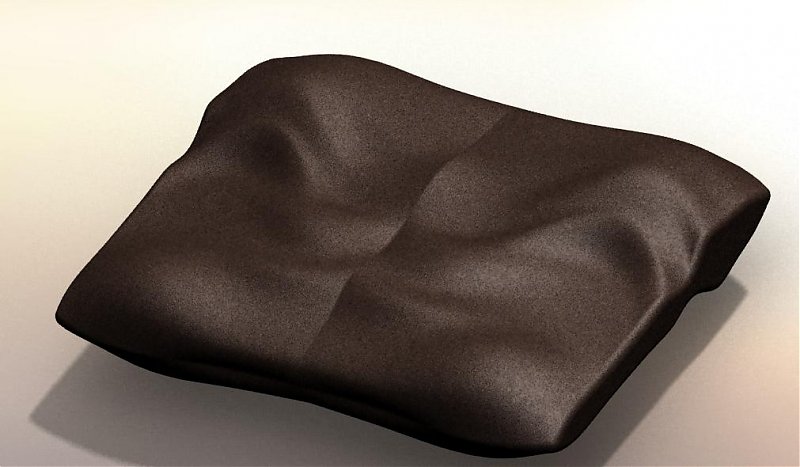

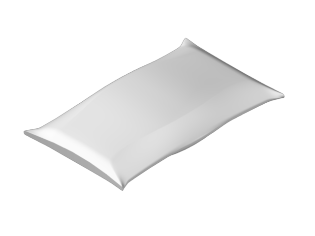

lilrose Posted January 13, 2009 Posted January 13, 2009 im all new to autocad, n ive been tryin to make a pillow from autocad2007 application. I've used loft with 3 interfaces n this is all i cud come up with. Shall i use any other command or is there anyway i cud make it look more like a pillow with the right material from the lofting command? This is my first thread..so i dunno much abt posting n replyin...i hope that i'd be notified when replied to my thread. My english may not b dat good since im not from an english speakin country..n i dunno all the autocad terms bt hope u'll understand Quote

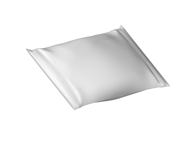

lilrose Posted January 13, 2009 Author Posted January 13, 2009 This is my next try pillow backup.dwg Quote
fuccaro Posted January 13, 2009 Posted January 13, 2009 lilrose First of all: welcome in the forum! As you found out, AutoCAD is a program for objects with regular surfaces, like the machined ones. I don't say you can't create pillows or human faces or other "natural" or "organic" models, just the way is longer. Your second pillow is quite pretty. Quote

lilrose Posted February 25, 2009 Author Posted February 25, 2009 Welcome to the forum qwerty. Im sure there must b an easier way to do this bt i can tell u how i did it. I made profiles for different cross sections in the pillow and lofted it. Ive attached the cad file with the profiles of the cross-sections (bt not lofted). Hope this will help u:) pillow backup.dwg Quote

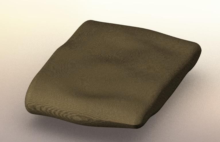

shift1313 Posted February 25, 2009 Posted February 25, 2009 making something organic is a big challenge in a software like this. I think you did a great job with it. the biggest thing you need to watch for is sharp corners. I would set it up like a bunch of cross sections of the pillow. make sure you change the width/height/profile through these sections. The fewer sections you can use, the smoother the shape and more organic the loft will be. The more you stick in there, the more defined things will be. Here is something i did real quick. it was 4 cross sections, then mirrored 3 times. I tried to simulate what the pillow would look like if a head were set on it. Other programs like Inventor are better because you can go back and alter your splines and update the model. Acad you have to undo, modify then re-loft. I dont recommend using mirror. it will make your object less organic that way(like the seam in the middle of mine. Dont forget you can use guides as well Quote

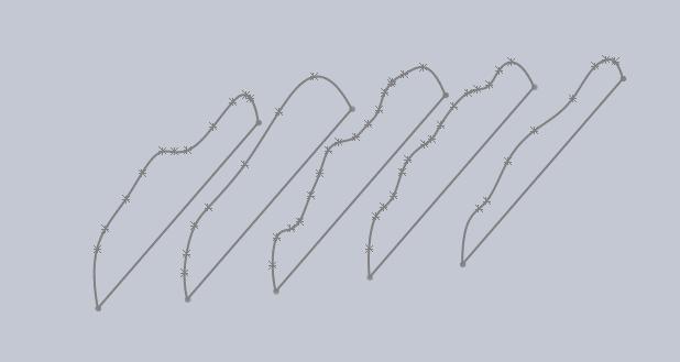

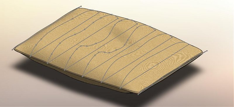

shift1313 Posted February 26, 2009 Posted February 26, 2009 here is one i drew real fast so you could see the cross sections. this wasnt done in Acad but the procedure is the same Quote

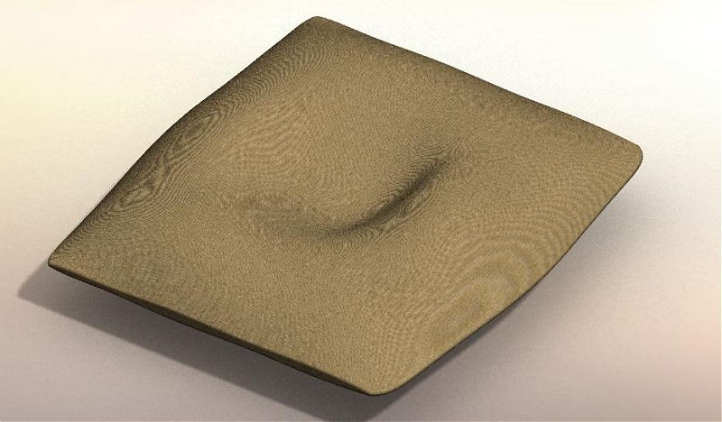

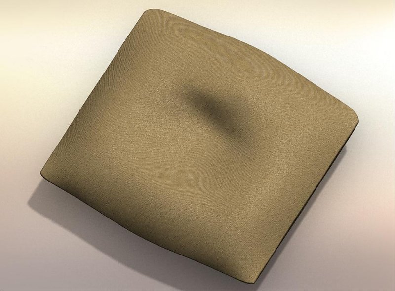

shift1313 Posted February 26, 2009 Posted February 26, 2009 if you actually come up with a plan for what you want it to look like you can draw a spot where a head would have been. Just remember to not make your sketches too close to each other or you will get sharp transitions. here is one with a "impression" I think for something like this, the edge is going to be the most difficult thing to get to look real. I think a hard edge with a very small fillet might give the right look. also another note. even if your pillow fabric started out as a rectangle, remember it will bulge out in the middle. Make sure some of your middle segments are wider than the end segments. Quote
shift1313 Posted February 26, 2009 Posted February 26, 2009 oh and just in case you ask. here are the cross sections. Quote
