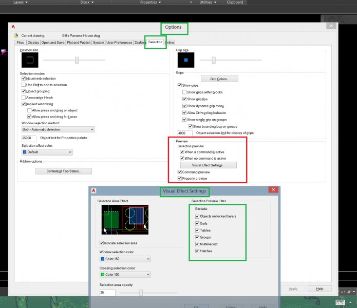

Some of these guys may be your issue, espaecially what happens during a command, or when no command is active. If you like to pick first like me, not having "When no command is active" checked will cause the selected items to not highlight. Inversely, not checking "When a command is active" will cause objects to not highlight when you do already have a command going.
EDIT:phooie, the pic is so small I can't even read the text on a 24" screen. Hope you have a touch so you can zoom. If not, OPtions > Selection...

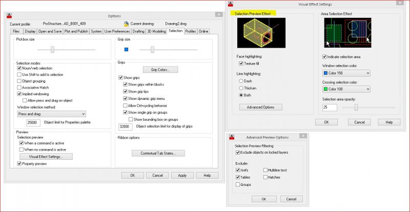

Dana, sounds like you mean this Selection Preview Effect, which is in 2013.
If you check for a similar name in your SYSVDLG, you might just find that they turned it into a system variable too. :beer:
EDIT: and then I realised this only pertains to the selection preview (hover behavior) The old controls let you turn highlight on and off, and whether or not to make the selected objects go to dashed lines at the same time. Those are GONE.
