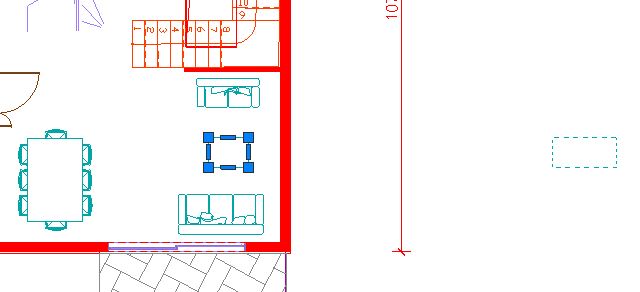

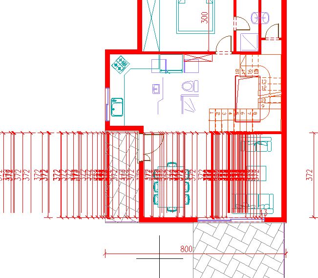

I have two display issues when I display the layout in one of the models:
1. When I add a Linear Dimension - the dimension line is display multiple times. ( please see AF1QipNbV6dx52V6Spx64RdmhwJb8JTRjmSjlljJCsPE?source=pwa&authKey=CNaU8_f8z4DalgE#6404844445159674546)
2. When I click on an object (e.g. a rectangle), the selection mark is displayed far a way and not on the object itself (please see AF1QipOaw7UJdafcrIvjfiWXrwL0u2VnN2zGEfPj4bbc?authKey=CNaU8_f8z4DalgE).

Thanks ail for your replies.
The problem was with my models in the layout - all models were assigned to Realistic view - I changed the view to Wireframe and all is OK now.
I am attaching the two images for clarification.
