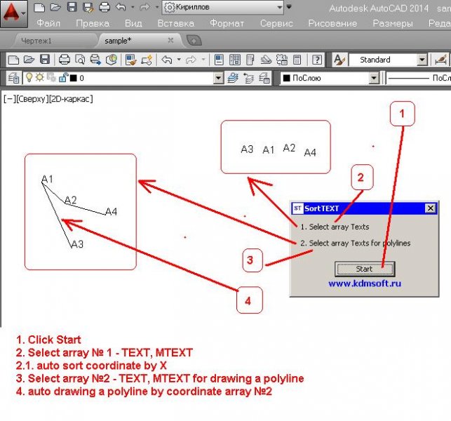

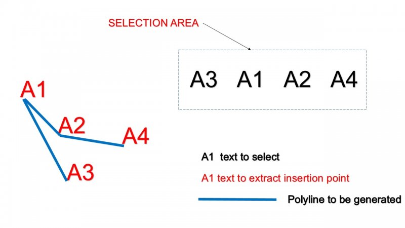

I want to select multiple text and sort them in x-coordinate and match the sort order to new selection set of text (red color).Then generate a polyline from the insertion point of the text (red color).
refer to the image below.
thanks guys
I don't see the text on the image being sorted by X nor Y, from the array you displayed.
Either it would be:
  • A1 A2 A4 A3 - descending Y sort
  • A3 A4 A2 A1 - ascending X sort
Ofcourse can the above can be reversed.
Soo consider this:

Grr what you have done is good but is not the answer just pick the text {4 picks} from the drawing in the order you want, make a list of co-ords and make a pline.
Grr You are right about sorting on X if you are picking say 4 texts A1 A2 A3 A4 then you have to search for that text in dwg and find co-ords of it and make pline.
Other version is "A1 A2 A3 A4" single text again search and make pline.
rrulep need to post a sample dwg or confirm exactly which method is it or all 3 ?
Re 1st comment you can do lisp inside the "Pline pick point" so get text point so no need to make a list.

This is exactly what I'm looking for.
Perfect!!!
Thanks Lee,
