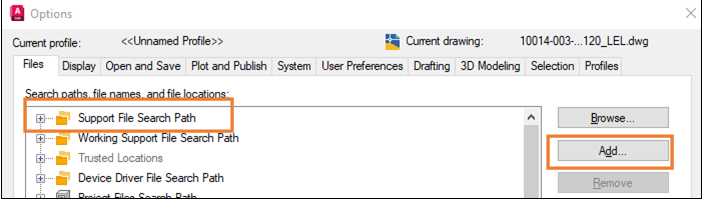

pkenewell Posted February 27, 2024 Posted February 27, 2024 (edited) @DELLA MAGGIORA YANN The Lisp and the DCL file should both be in one of the AutoCAD search paths. You can see what these are in the "Files" tab of the OPTIONS command; "Support File Search Path". You can also add your own folders into the search paths by selecting "Add" on the right side. Edited February 27, 2024 by pkenewell Quote

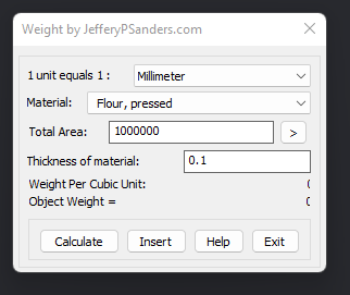

DELLA MAGGIORA YANN Posted February 27, 2024 Posted February 27, 2024 ok I put the DCL in SUPPORT and it works now, however I don't know how to put the correct units I would like to have a drawing in millimeters, a material thickness in millimeters and a result in kilograms and then I have a display problem, in fact the result is only partially displayed, can you help me please I am very bad at LISP language Quote

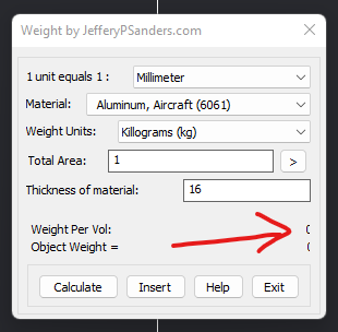

DELLA MAGGIORA YANN Posted February 28, 2024 Posted February 28, 2024 Il y a 9 heures, pkenewell a dit : Édité à nouveau ci-dessus et localisé toutes les variables. Great work, you impress me!!! this seems to work. However, I have a display problem in the dialog box. In fact the results are not visible, I will provide you with a screenshot. I have another question to make sure I understand correctly. -1- I therefore choose milimeters because my model is in milimeters, -2- I choose my material, “glass” -3- I choose the weight unit “kg” -4- I select or manually enter the surface in millimeters “mm²” and this should give me the result of the volume and the weight? and as I told you I can't see the results because of the display problem. I would like to thank you for your work. Quote

pkenewell Posted February 28, 2024 Posted February 28, 2024 8 hours ago, DELLA MAGGIORA YANN said: this should give me the result of the volume and the weight? and as I told you I can't see the results because of the display problem Very Strange. It works fine in my AutoCAD. It may have something to do with your display settings. I will play around with the DCL file and see if I can get it to do something different. Quote
pkenewell Posted February 28, 2024 Posted February 28, 2024 (edited) @DELLA MAGGIORA YANN OK. I made an update to the DCL in my Post above. Please re-download it and give it a try. I changed the DCL to use edit boxes for the results instead of just text labels. hopefully this will work better in your setup. Example: Edited February 28, 2024 by pkenewell Quote

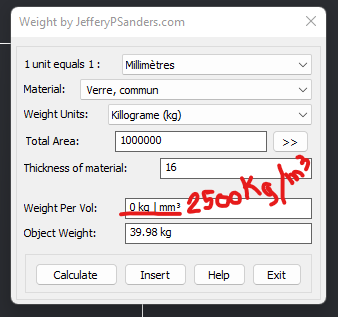

DELLA MAGGIORA YANN Posted February 28, 2024 Posted February 28, 2024 It's good, it works, it's great, a big thank you just a small question if possible otherwise it doesn't matter, it can stay like that. Do you think it is possible to put the density in kg/m3? as on screenshot keeping the units in millimeter if it's not too complicated of course. another thousand thanks you are great Quote
pkenewell Posted February 28, 2024 Posted February 28, 2024 (edited) @DELLA MAGGIORA YANN Great! I am glad it's working for you. Note - the program is completely dependant on the selected units. If you want it to show in kg/m3, just temporarily change the units at the top to "Meters" and it will update the density in real-time, then you can change it back to "millimeters" for the correct object weight to be displayed. I like this program and I may revisit the program at sometime in the near future and re-write it for more features, but for now this will have to do for you. Edited February 28, 2024 by pkenewell 1 Quote
