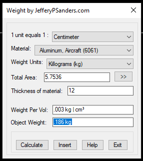

BrianTFC Posted April 3, 2017 Posted April 3, 2017 Eyal, Go here scroll down his list and you will find a "WEIGHT" program that works great. http://www.jefferypsanders.com/autolisp.html Quote

BrianTFC Posted July 2, 2020 Posted July 2, 2020 All, Jetxcc here is the lisp routine that I was talking about since Jeff's site is down. WEIGHT.dcl WEIGHT.lsp 1 Quote
jetxcc Posted July 7, 2020 Posted July 7, 2020 Thank you Brian TFC. I'm currently having issues with the DLC not being recognized as being in the search path. But I'm sure I'll get it sooner or later. Thanks again. But does anybody know why JPS website is no longer working? or is it just me? Quote
BrianTFC Posted July 7, 2020 Posted July 7, 2020 it works better if the lisp and the dcl are in the same folder. Quote

jetxcc Posted July 7, 2020 Posted July 7, 2020 (edited) I clicked on the link that you provided, downloaded the lsp & dcl files. cut and paste them into my lisp folder with all of my other lisp routines did the app load and nothing. I'm about to try a CAD shut down and reopen to see if that does it or not. the shut down and restart of CAD seems to have done it. Edited July 7, 2020 by jetxcc Quote
eyal Posted July 8, 2020 Author Posted July 8, 2020 Hi @BrianTFC, Thank you for the lisp. but I can't fint the steel density 7.85 g/cm3 . and I work with this density , where can I change it in the lisp? Thank you Quote

eyal Posted July 8, 2020 Author Posted July 8, 2020 Hi BrianTFC, I liked you lisp , that I can choose from a list the density, but as I said I use steel density of 7.85 g/cm3 I want to change values in your list for specific materials ( also I use mm units) in your list I found this: "437.0" ; Iron, ferro-silicon "325.0" ; Iron ore, hematite "170.0" ; Iron ore, hematite in bank "145.0" ; Iron ore, hematite loose "237.0" ; Iron ore, limonite "315.0" ; Iron ore, magnetite "172.0" ; Iron slag "710.0" ; Lead "465.0" ; Lead ore, galena "112.0" ; Magnesium, alloys "475.0" ; Manganese "259.0" ; Manganese ore, pyrolusite "849.0" ; Mercury "556.0" ; Monel Metal "565.0" ; Nickel "1330.0" ; Platinum, cast, hammered "656.0" ; Silver, cast, hammered "453.0" ; Steel, rolled "459.0" ; Tin, cast, hammered "418.0" ; Tin ore, cassiterite "440.0" ; Zinc, cast, rolled "253.0" ; Zinc ore, blende as you can see steel rolled is 453 what is this value? , it supposed to be 7.85 g/cm3 I don't understand the values here. Can you change the density list to be in g/cm3 Density (near r.t.) 7.874 g/cm3 https://en.wikipedia.org/wiki/Iron Thank you, Eyal Quote
