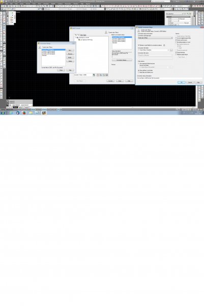

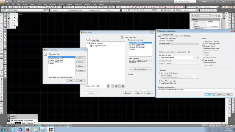

jim78b Posted March 29, 2017 Author Posted March 29, 2017 original ac1027.dwgnow i attach the original file (i see the version with notepad and write the version in the name of the file) and then the dwg converted. for my disappoint the converted file is a ac1027 version the same of the original. i want convert in in 2000 with dwg convert but anything! converted ac1027.dwg Quote
SLW210 Posted March 30, 2017 Posted March 30, 2017 Converted fine for me using DWG TrueView 2016. I can't really see your images that well. ac1027 - ac1015.dwg Quote
SLW210 Posted March 30, 2017 Posted March 30, 2017 Maybe you should try using DWG TrueView, it is free from Autodesk. Quote
