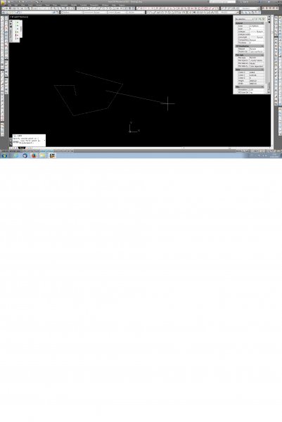

jim78b Posted March 22, 2017 Author Posted March 22, 2017 You are assuming it is a bug in Mech 2013. Test that theory. Open a new (blank) drawing and create a new block using polylines with a width set to .001 then copy/move and see what happens. i just made as you told me. and this happen again! width 0.1 .whick version of autocad do you have? i see if you change in visual style 2d wireframe to wireframe you can see the polylines when moving...i am very frustrated about this Quote

Dadgad Posted March 23, 2017 Posted March 23, 2017 Dadgad, the OP is talking about seeing the objects as he's copying and moving them around on screen. Yes, after you copy and paste to a new location they do display correctly, but are you saying you can see them while you're copying them, while the Copy or Move command is still in progress? For instance, trying Moving the man block. Can you see the elements of the block as you're moving it, or only after you have completed the command? Take a look at the screenshots below. The first one shows me trying to move the man block. As you can see, there is no preview of the block as I'm moving it. The second screenshot shows me moving the block after I edited it and exploded all the polylines. As for the size issue, maybe it is as you said. I work in Imperial units so when I measure the man block, he measures 146' tall. Cad64, your screenshot shows a lot more points from the outline of the man. Mine seems to be displaying sort of critical vertices, as opposed to whole lines, but enough that I can tell where it is. I would approximate about 50 vertices, not enough that I would have any idea WHAT it is, if I didn't already know. It displays the same for Copy or Move. As per ReMark's suggestion, my polyline width is set to default. Quote
