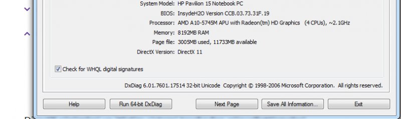

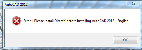

hht Posted March 20, 2017 Posted March 20, 2017 I try to install Autocad 2012 to my win 7 laptop but I am taking some errors. But I have checked that directx 11 is already installed. I have also checked the other related threads. http://www.cadtutor.net/forum/showthread.php?63941-Can-t-Install-AutoCAD-2012&highlight=directx http://www.cadtutor.net/forum/showthread.php?61118-AutoCAD-2012-Installation-Error-1603-quot-Error-Please-install-DirectX-quot-before-instal&highlight=directx http://www.cadtutor.net/forum/showthread.php?45902-AutoCAD-2010-Windows-7-installation-error-issues&highlight=directx http://www.cadtutor.net/forum/showthread.php?32340-installation-problem&highlight=directx http://www.cadtutor.net/forum/showthread.php?95502-AutoCad-Installation-Problems&highlight=directx Can it be a solution to install DX 10 instead of 11? Thank you. Quote

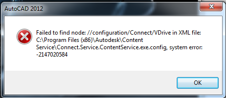

hht Posted March 20, 2017 Author Posted March 20, 2017 Before above error, I have taken this one: Thank you. Quote
ReMark Posted March 20, 2017 Posted March 20, 2017 I don't suppose that you tried doing an Internet search on the specific error message you show in your first post did you? My guess is the answer is "no". https://knowledge.autodesk.com/support/autocad/troubleshooting/caas/sfdcarticles/sfdcarticles/AutoCAD-2012-Installation-Error-1603-Error-Please-install-DirectX-before-installing-AutoCAD.html As for the second error message this may help... https://forums.autodesk.com/t5/installation-licensing/error-1402-and-error-failed-to-find-node/td-p/3626236 Quote
hht Posted March 20, 2017 Author Posted March 20, 2017 ReMark said: I don't suppose that you tried doing an Internet search on the specific error message you show in your first post did you? My guess is the answer is "no". https://knowledge.autodesk.com/support/autocad/troubleshooting/caas/sfdcarticles/sfdcarticles/AutoCAD-2012-Installation-Error-1603-Error-Please-install-DirectX-before-installing-AutoCAD.html As for the second error message this may help... https://forums.autodesk.com/t5/installation-licensing/error-1402-and-error-failed-to-find-node/td-p/3626236 You are somehow right. As I referred to, I made the search here. Meanwhile would you please explain how I can install dx10 instead of 11? There are lots of error I cannot handle all of them in a short time. Thank you. Quote
ReMark Posted March 20, 2017 Posted March 20, 2017 Why do you want to install version 10? Typically you want to address one problem at a time. I'd start with the one that says "Failed to find node.....". Quote

hht Posted March 20, 2017 Author Posted March 20, 2017 But I don't understand why I again install directx. Because as you can see from screenshot in my #1, DirectX 11 was already installed. What is the process I have done by downloading and installing something located in this link https://www.microsoft.com/en-us/download/details.aspx?id=8109? This is just about languages Quote This download provides the DirectX end-user multi-languaged redistributable that developers can include with their product. The redistributable license agreement covers the terms under which developers may use the Redistributable. For full details please review the DirectX SDK EULA.txt and DirectX Redist.txt files located in the license directory. Thank you. Quote

ReMark Posted March 20, 2017 Posted March 20, 2017 Your profile says AutoCAD 2013. Why are you trying to load AutoCAD 2012? Did you first fix the problem related to the error message re: "Failed to find node...?" Yes or no? That's where you should start. Fix one problem at a time and in the order they were encountered. I was hoping we could get you back to a time just before you tried installing AutoCAD 2012. That would take a restore point. It doesn't necessarily mean that if you roll back the system you'll do any real harm to the rest of the system. You may lose a Windows update but that won't be the end of the world. Quote
Dana W Posted March 20, 2017 Posted March 20, 2017 (edited) A restore point will not help you get past the Directx error, but it at least would give you a clean OS to install in. Lost Windows updates replace themselves. Restoring Windows may re-install the uninstalled AutoDesk content services utility if you have gone back and uninstalled it already. That is basically just like the directx problem. The version you already have/had is too new, so it needs to be replaced for the AutoDesk installation. AutoCad installer runs right past OLDER versions of programs and utilities it needs and updates them, including Directx and the content services, but it chokes on newer versions. You'll have to find somebody with AutoCad 2011 or 2012 and copy their directxsetup.exe from the location in their files, named as you posted above. The out of date version of Directx that AutoCad 2012 needs to run is no longer available from Microsoft. The version of Directx installed on your computer is so much newer than the 2011 version needed, that it is not recognized by the 2012 AutoCad install program. Your installation cannot find the proper version on your computer, nor on the internet, so it stops. Come to think of it, installing the older Directx may overwrite the newer one causing potential problems with some of your other programs. I have even had older versions of programs refuse to install when it finds a newer instance of itself already there. Edited March 21, 2017 by Dana W Quote
hht Posted March 21, 2017 Author Posted March 21, 2017 ReMark said: Your profile says AutoCAD 2013. Why are you trying to load AutoCAD 2012? I would like to use both of them ReMark said: Did you first fix the problem related to the error message re: "Failed to find node...?" Yes or no? That's where you should start. Fix one problem at a time and in the order they were encountered. I have ignored it but after installing that direct x end user runner every thing easily completed. ReMark said: I was hoping we could get you back to a time just before you tried installing AutoCAD 2012. I still don't understand why we would do this although I like both 2012 and 2013 versions. P.S: Before I completed installation of AutoCAD2012 and while taking those error messages, I tried to install 13 and it was easier. Than I asked the question here. Why 2013 was very easy but 2012 was painful? Thank you. Quote
