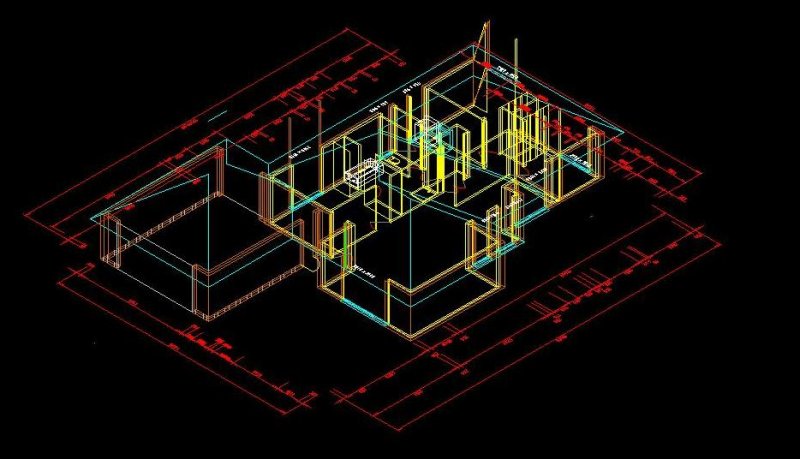

Thanks. I did the hotel and restaurant drawings with title block in the autocad software but he said the lettering is too small. Is there any way to make the print bigger. He wants the print really big. I've attached a file which he said the print in it is too small.
hot_plan1.dwgFetching info...
1st lock your viewport its makes life so much easier
2nd the problem is that your dims are all over the place make them all line up in a even line or multiple lines, sorry not on right computer for displaying a 3 line dim arrangement, 1st is individual rooms 2nd is overall dims and 3rd is outside measurement. Someone will post an example overnight.
3rd try 5/32 for text size. I am metric but that sounds about right for your title block size.
