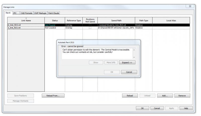

roshen_aliary Posted March 16, 2017 Posted March 16, 2017 (edited) Hi Everyone, I am here again because when I manage a links, this message pop-up again on my screen, I need to know why this message come out? So sorry, please anyone can help me! Thanks in advance! Edited March 16, 2017 by roshen_aliary The attachment does'nt come out Quote
tzframpton Posted March 16, 2017 Posted March 16, 2017 See my post in your other thread. Basically what's happening is you didn't open the Revit file correctly, so items are locked out. You will need to Detach from Central and create a new Workshared model and save, then create a Local Copy. Your other thread I posted is here: http://www.cadtutor.net/forum/showthread.php?100123-Opening-revit-file&p=680974#post680974 -TZ Quote
roshen_aliary Posted March 16, 2017 Author Posted March 16, 2017 Hi TZ, Thank you so much. More power! Quote
