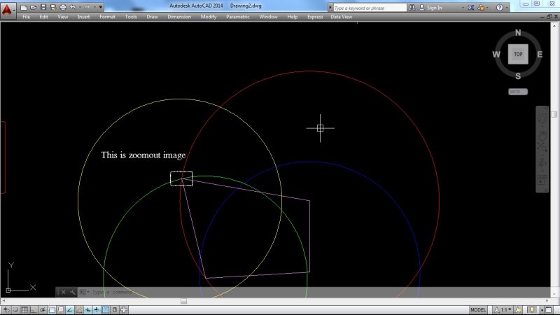

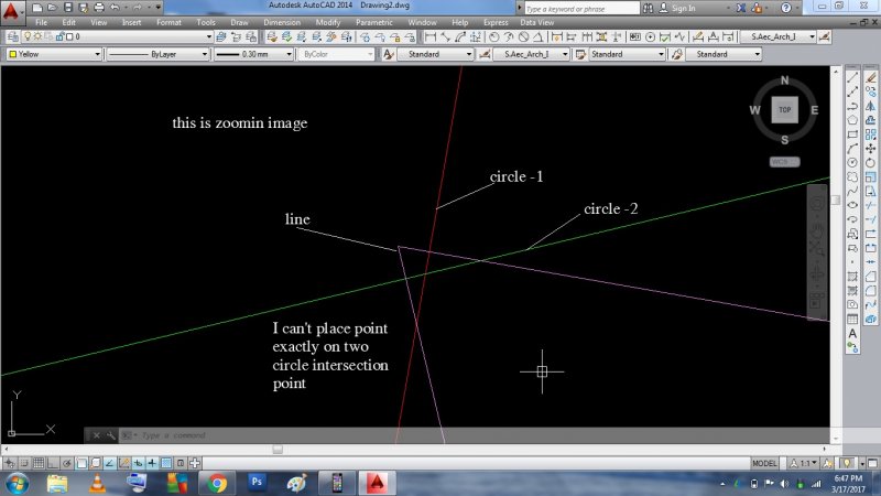

dgp123 Posted March 17, 2017 Author Posted March 17, 2017 hi, again need help i can't exactly place my poly line on point which is two circle intersecting point....please refer this image. i don't know it may solve my snap setting or by other mtd. some one please guide me..... and one more question is any lsp for pick point any where exactly on circle.... Quote
hakmawongzi Posted March 17, 2017 Posted March 17, 2017 (edited) Zoom in and type "regen" on the command line, it will take care of it. Edited March 18, 2017 by hakmawongzi Quote
dgp123 Posted March 18, 2017 Author Posted March 18, 2017 Regen command perfectly working thanks bro...... Quote
