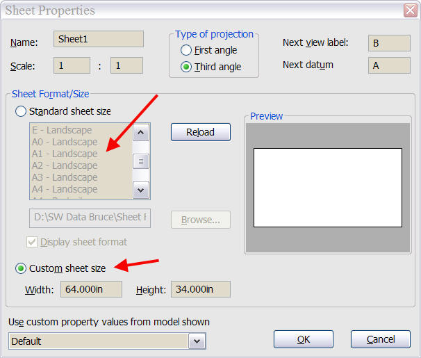

Does anyone know how to get different page sizes for drawings other then the ones already in the page setup? I have A6, A5, and A4 but no A3 through A0.
Note that i use SW 2007.
Page sizes are setup from within the printer / plotter you wish to print / plot to.
Those sizes should be there. If not they were accidentally deleted from sheet format folder.
You can specify custom paper sizes by RMB “sheet Format” in manager and click “properties”.
