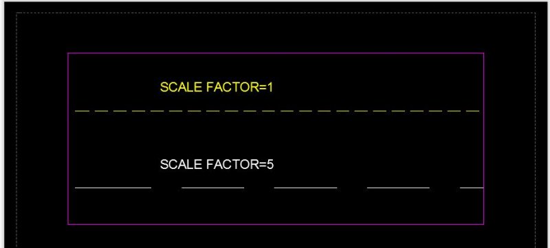

Are you using a layout and applying a scale to the viewport?
As seen in model space. The yellow line at the top was drawn on a layer named Test which was assigned the Hidden linetype. LTSCALE is 1. The white line below it was drawn on layer 0 which normally uses the Continuous linetype HOWEVER I used my recently created HiddenLine tool which, as noted in its Properties, had its linetype changed to Hidden and the scale changed to 5. LTSCALE remains at 1.
Edited by ReMark
Same two lines as seen in a layout with a viewport (magenta color) scale of 1:2. LTSCALE has not been changed. It is still 1.
