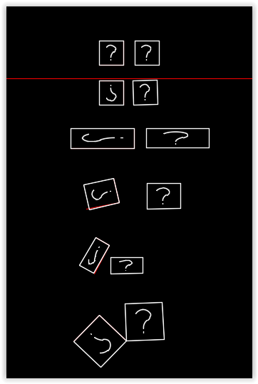

grouch19 Posted March 6, 2017 Share Posted March 6, 2017 G'day all I'm working on and editing a mapping project from photogrammetry. I have a block which indicates a square manhole cover. (File is attached to this post) My project area has hundreds of these manholes and my client needs each of them scaled and rotated to fit the exact size of the manhole. I had been manually doing this with the help of an ECW image in the background. But the process is rather tedious and not all that accurate. My operators can pick up a three point string showing the height and length of the manhole. Some manholes are square and some are rectangular. I have a few lisp routines that get the block in there. The block insertion point comes in at the first plotted point as required. Is there any similar LISP that will insert the attached block dwg file at the first point collected and scale it based on the 2nd and third point whilst keeping the elevation heights? I've attached two dwg files... One is the block itself and one is a diagram with a better explanation. I've also added a screen shot of what is required. Any help would be appreciated Cheers guys Manhole.dwg BlockSample.dwg Quote Link to comment Share on other sites More sharing options...

grouch19 Posted March 6, 2017 Author Share Posted March 6, 2017 Drawing4.dwgHi BIGAL Thank you for the reply I have tested this routine. The block does come in but the scale and rotation seem off. I've attached a DWG of what happens. This DWG file has the original 3 point line still there to show the results. My block is 1m x 1m so that should be fine. It does appear to be using the first point as its insertion point which is great. Just not sure why it is making the block so huge and not at the right size/scale. Cheers Quote Link to comment Share on other sites More sharing options...
BIGAL Posted March 7, 2017 Share Posted March 7, 2017 I should set the angles to radians and anti clockwise then set back to what you had before. Try above code revised. Worked ok for me. Quote Link to comment Share on other sites More sharing options...
grouch19 Posted March 7, 2017 Author Share Posted March 7, 2017 Thanks BIGAL Unfortunately it is still playing up. I did make a stupid mistake yesterday though. In the test files I was using i had the units set to Inches. I have tried using both your routines with the units set to meters and got some mixed results. If my 3 pt string has pt1 to pt2 at 90 degrees and pt2 to pt3 at 0/360 degrees it works perfectly. However as these lines are collected via photogrammetry and the manholes are all at random angles and spacings the 90 degree angle isn't really going to happen. I tested the routines with pt1 to p2 running at an approx 20 degree angle and the block won't come in at that angle. It seems to rotate it slightly upwards but nowhere near the original pt1 to pt2 distance. It's almost as though once the angle is less than 90 degrees it fails. The attached dwg file shows some of the results. Note I have shifted the red original 3 point line(s) to the left to illustrate the issue. Really appreciate your time mate. CheersDrawing-blocktest.dwg Quote Link to comment Share on other sites More sharing options...

BIGAL Posted March 8, 2017 Share Posted March 8, 2017 (edited) I fixed one mistake aunits should have been 3 in code above, I have to add the Mirror last to get clockwise anti clock wise. Found a simple answer for left right, code updated. Tested on your sample dwg did them all in one go. It is feasible to rotate the block rather than mirror version 2. Edited March 8, 2017 by BIGAL Quote Link to comment Share on other sites More sharing options...
grouch19 Posted March 9, 2017 Author Share Posted March 9, 2017 Hi BIGAL, I'm afraid I am still getting the same results as yesterday. Seems strange how the 90 and 360 degree lines seem to work but once the 3pt string is of those angles the block sits off. I've attached a screen shot of my results. I've got my units menu open also to show you my setup. The red line is the original 3pt string. The insertion point is perfect as are the distances from pt1 to pt2 and from pt2 to pt3. It appears the issue is all around the rotation area. I'm not that great at the LSP stuff so really appreciate your help mate. Cheers Quote Link to comment Share on other sites More sharing options...
BIGAL Posted March 9, 2017 Share Posted March 9, 2017 Not sure whats going on this is your sample dwg posted did all of them 1 after another. Anbody else out there what might be wrong Quote Link to comment Share on other sites More sharing options...
grouch19 Posted March 9, 2017 Author Share Posted March 9, 2017 It works!!! Not sure what was going on. I did a manual restart of AutoCAD and upon restart it works perfectly! Sincerely appreciate all your help BIGAL! Now I'm off to scale and rotate a few hundred manholes "automatically!" Thanks again mate. Cheers Quote Link to comment Share on other sites More sharing options...
