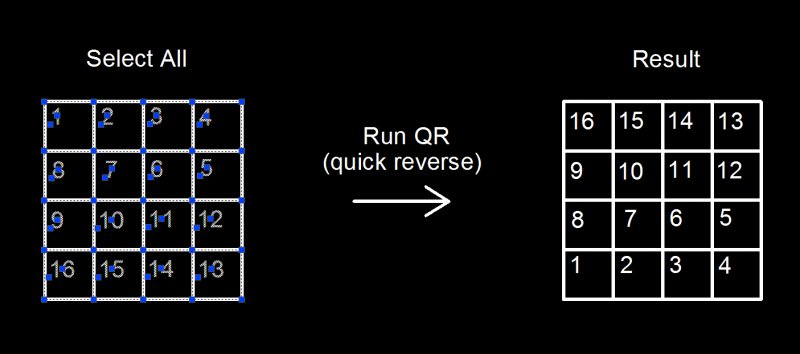

I regularly use text to number objects for designating cut order. In the past, I have cobbled together some code that can quickly increment or decrement all selected numerical text in case I make a mistake and/or have to change something. This works marvelously, but often, I find that I need to go beyond that and completely reverse the order.
Using this code as a starting point, I thought this would be super simple but the fact that I'm trying to do list manipulation to text objects is completely throwing me off. I'm still a bit new to this sort of thing. I was thinking I'd get a list of all selected text, sort it, then reverse that list before applying changes to the text. Highest number gets swapped with the lowest, second highest with second lowest, etc.
("1" "2") would become ("2" "1")
("2" "1" "4" "5" "3") would become ("4" "5" "2" "1" "3")
("2" "8" "17" "4") would become ("17" "4" "2" "8")
("3" "5" "-4") would become ("3" "-4" "5")
I'm not sure where to start, nor what process to use. My main problem is that I can't figure out how to sort and edit the data without losing links to the correct text objects. Any help would be awesome. Here is the my quick increment/decrement routine that I'm trying to start with.

Thank you for the replies.
The code I quoted is my starting point for dealing with the text objects. I'm aiming for the finished program to work the same as code I posted, except that instead of incrementing the numbers, it reverses them.
I will experiment with the examples you guys gave and see what I can build. It looks like the associated list will probably be the way to go if I'm able to make it work correctly.
Just for clarity, this image is an example of what I am attempting to do.

Not necessary a assoc list. In fact, it is more easy in this case with 2 different lists.
(defun c:qr ( / ss i e s obj num n u m)
 (if
   (setq ss (ssget "_:L" '((0 . "TEXT"))))
       (setq e (vlax-ename->vla-object (ssname ss (setq i (1- i))))
             s (vla-get-textstring e)
       (if
         (and (setq d (distof s)) (equal d (fix d) 1e-)
         (setq obj (cons e obj)
               num (cons (atoi s) num)
     (if num
         (setq n (vl-sort-i num '<)
               u (mapcar '(lambda (x) (nth x num)) n)
               m (1- (length num))
         (mapcar
           '(lambda (e x)
              (vla-put-textstring e (itoa (nth (- m x) u)))
           obj
           (vl-sort-i n '<)
Works with duplicates, but the result is unpredictable (I guess it shouldn't be any duplicate).
Woah, that works great! I'll have to look it over and see if I can understand everything that's going on in it. Thank you very much!
