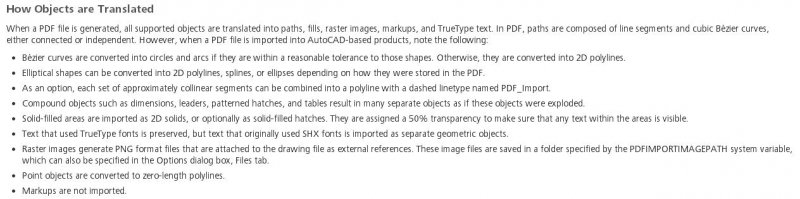

ReMark Posted February 28, 2017 Posted February 28, 2017 (edited) AutoCAD 2018 has not been released yet so I see no reason why you cannot purchase AutoCAD 2017. There are no more perpetual licenses meaning you have to accept going to subscription and paying a yearly maintenance fee. The other alternative is to rent/lease AutoCAD. Further details can be obtained at the AutoDesk website. How objects are handled during a PDF to DWG conversion in AutoCAD 2017.... Personally, I'd rather redraw from scratch. Edited February 28, 2017 by ReMark Quote
SLW210 Posted February 28, 2017 Posted February 28, 2017 There are actually some pretty good converters, the output usually depends on the quality of the PDF, etc. If these are scanned raster PDFs, the best bet is to trace them. If they are not of the very best quality, the results are usually unusable in my experience. If there is enough information on the PDF I usually just redraw from scratch, I don't even bother tracing. Quote

ReMark Posted February 28, 2017 Posted February 28, 2017 The reference came straight from the AutoCAD 2017 Help file. Users can insert a PDF using the ATTACHPDF command and trace over the image or if they have a digitizing board they can trace over a printed copy of the PDF. I've done both. Quote
tzframpton Posted February 28, 2017 Posted February 28, 2017 The full version of AutoCAD 2017 has built-in PDF to DWG conversion (vector only, not raster/scanned) and I have used it on numerous occasions and it works good. Granted, it's never perfect, but for background purposes, it is sufficient. Before AutoCAD 2017 I used the free vector program Inkscape to import vector PDF's, then save as a DXF and it has worked well through the years. It's a bit of a process since you are using a second program. You have to import/save as, then open in AutoCAD and scale using a reference, and so forth. But, it works, and it's legitimately free (if cost is of concern). -TZ Quote

LydiaGP Posted February 28, 2017 Author Posted February 28, 2017 tzframpton said: Thanks! It's about time to fire it up. The main downfalls are this: Circles and arcs become segmented lines/plines. SHX fonts become lines instead of retaining their original TEXT entity so no editable text unless it was used with TTF fonts. Accuracy is compromised. Something that is exactly 36" long will become 36.125" or 35.95", for example. Unless Layers were retained during the PDF output process, no layers whatsoever. Hatches are completely exploded. Dimensions are exploded. In fact, most if not all things come in as an exploded state. There are many others but these are the main issues. -TZ Thanks for the list, that's very helpful. Just what I was needing to know. Ironically accuracy probably won't be critical as the customer likely won't be viewing the equipment layout in any type of software that they could even see the actual line lengths on. But since dimensions are exploded, it sounds like it would be necessary to re-dimension to have a truly useful drawing in which case the inaccurate line lengths are a problem again. So this comes back to just like you guys said, re-draw if it's not just being used as a background. Thanks so much for the good explanation. I'll still try to get a sample PDF up here and will play around with it a little myself as well. Quote
