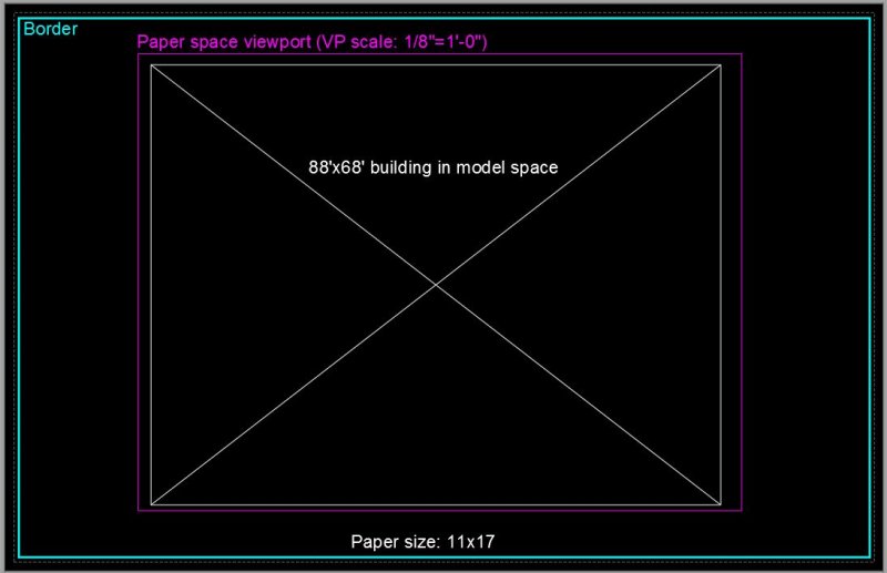

Without actually checking using AutoCAD I'm guessing your 88'x68' building will not fit on a 8 1/2x11 sheet of paper (landscape orientation) and still leave room for a title block and border. You'd most likely have to go to 11x17 size. If you bump the viewport scale up to 1/4"=1' then you'll need to use a 18x24 sheet size but once again I'm pretty sure it will not allow you enough room for a titleblock and border.
Look at it this way. 1/8"=1' is the same as saying 1"=8'. A sheet size of 8.5x11 could theoretically accommodate a rectangle 8*(8.5)x8*(11) or 68x88 but that rectangle would have to be drawn on the very edge of the paper which no cad drafter would ever conceive of doing.

An example using your building dimensions.
