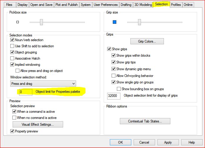

steven-g Posted February 23, 2017 Posted February 23, 2017 I think you might need to upload the drawing so someone could take a look, but as a wild guess is it a large drawing, could there be thousands of items in the returned selection set, if so take a look at the Autocad options on the selection tab there is an option to set the max number of objects for the properties palette (left hand side), setting that to zero will allow an unlimited amoount, it is set at 25000 by default, and anything above that it will show "no selection" Quote
Dadgad Posted February 24, 2017 Posted February 24, 2017 (edited) +1 Sounds like a good hypothesis steven-g! In 2013, it says that the maximum selection set for properties is 32,757. Edited February 24, 2017 by Dadgad Quote
steven-g Posted February 24, 2017 Posted February 24, 2017 thats the one, in 2017 it was 25000, hopefully that will fix the OP's problem Quote

SuzanatParksNYC Posted February 24, 2017 Author Posted February 24, 2017 I tried your suggestions, and thought I had it, but that didn't work. This just came out of nowhere because I use this function pretty regularly. How do I attach or upload a file here Quote
