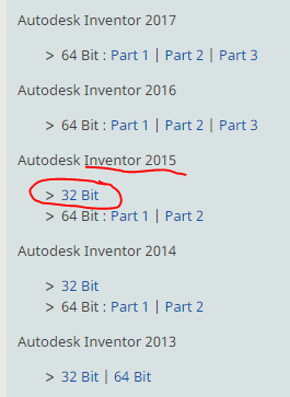

JD Mather Posted February 27, 2017 Share Posted February 27, 2017 Older versions available at this link - Autodesk Virtual Agent I don't recall when it went exclusively to 64 bit, but I am pretty sure it was after 2014 or 15. Edit: Looks like 2015 Quote Link to comment Share on other sites More sharing options...
