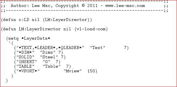

It looks like Tharwat has already got you back on the tracks, but fyi, one of my favorite LeeMac lisps is LAYER DIRECTOR.
Everyone on the planet should be using it, seriously.
It will do this for you, among other very useful things, like putting all Text on your TEXT layer (or wherever you tell it to, in advance), all your Viewports on a particular layer.
If the layer that is specified in the lisp doesn't yet exist in the drawing, it will create the layer, with the settings you have defined when setting up the lisp for your own personal needs. For instance, you probably want all your LEADERS on which layer?
Check out the link, it is absolutely awesome.
Thanks Lee! :beer:
You just need to give a little thought to what commands you want defined for any given layer, and the color and name for the layers.
This lisp works on the fly, you don't need to think about it, it will put things where you told it to, without any user interaction, and go right back to the layer you were on before calling whichever command, maybe DimRadial, for instance.

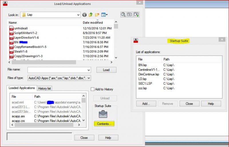

If you are like me, you will want this to LOAD automatically, so you never need to think about layers again.
I have loaded it into the Startup Suite, so everytime I boot up Autocad, it comes along for, and really smooths out the ride.

In order to better understand what this lisp does, and how to personalize it for your preferences, download it to your LISP folder, then open it with NOTEPAD. Lee includes a very helpful description of what it does.
