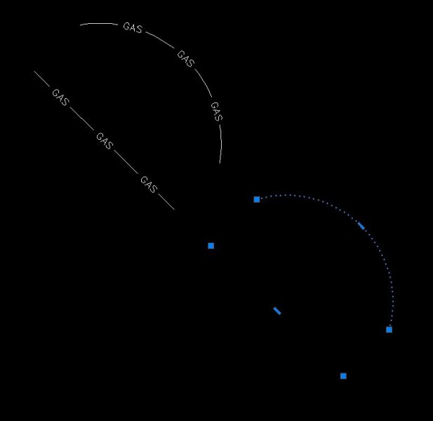

eyeofnewt555 Posted January 26, 2017 Posted January 26, 2017 Hey guys! So after seeing the custom invisible linetype on this thread, I decided to test it out. Works beautifully for straight lines (only displaying two dots at the very ends) but fails miserably at arcs. It looks like a single arc segment must actually be composed of multiple linear sub-segments, each of which get dots at their ends. This runs counter to behavior I've seen in other linetypes. The gas linetype in the pic flows smoothly, not jerkily restarting at every bend. And I was hoping linetype generation was the culprit, but nope, looks the same regardless of it being enabled/disabled. So do y'all know if there's a way to make a truly invisible linetype? Quote
eyeofnewt555 Posted January 26, 2017 Author Posted January 26, 2017 in case that first pic was too hard to see. Quote

eyeofnewt555 Posted January 26, 2017 Author Posted January 26, 2017 I'm not following. Just what is the purpose of an invisible linetype? Oh gawd, you again. I'm gonna pretend that we haven't interacted before and just try to be all civil and polite, despite you being...you. An invisible linetype would help in situations wherein I want Autocad to respond as though a line is there without providing visual clutter (aside from the end dots, it would be invisible both in the drawing and when plotting). Lets say I want to use lineworkshrinkwrap around several plant blocks that are near eachother, but not quite touching. Now if each of these blocks has an invisible circle drawn around it (within the block itself), offset by a little bit, this provides enough buffer for lineworkshrinkwrap to do what I want it to without cluttering up the drawing. That is just one example of an invisible linetype's applications. It was one example more than I owe you, and the last that I'll be sharing. If you have anything productive to add, by all means please contribute. If you have half-assed workarounds and critiques of my workflow, you can move along. Quote

mcweb Posted January 19, 2024 Posted January 19, 2024 I know it's an old topic, but .... Any update on this? My use is dimensions. The arrows and lines are tied together. If I want the arrows but no lines, I use this invisible linetype. My problem is when it's a small dimension and the lines are on the outside, this invisible linetype shows the 2 dots. Just little annoying dots! Quote
