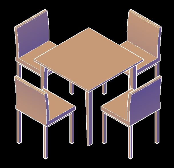

Going back to what Irm said about creating the furniture as solids and then saving as blocks. The table and four chairs seen below were created as solids and the drawing was saved. The file size is 186KB. If I open a new drawing and insert the table and chairs as a block then copy that block nine more times (for a total of ten blocks) and save the drawing the file size actually decreases to 144KB. If I were to explode each of those ten blocks (creating a mix of surfaces and regions) I end up with a total of 2510 objects in the drawing and when that drawing is saved the file size balloons to 1.36MB. And that's for a very simple table and chair arrangement.
ReMark,
Your exercise points out the efficiency gained by using blocks. An empty AutoCAD file is about 30KB so in your example the table and chairs consumes about 150KB. I would guess that each instance of a block adds about a 100 bytes (= 0.001KB) or so. A block instance includes: the name of the block, its layer, scale. location and orientation in 3D space and not much more. Ten instances of a block may add about 1KB but this is noise compared to the amount of data needed to define the geometry of the 4 chairs and the table. Your single instance file may have had some holes in the database as a result of the construction process of adding and deleting objects. This may account for the smaller file size for the 10 tables and 40 chairs.
You could get even better efficiency if the table-and-chairs blocks were defined as a table with 4 instances of a chair block.
There's no need to explode the block unless you wanted to change one instance of the table and chairs without affecting the other instances.
~Lee
All good points.
I mentioned exploding the block because that is precisely what I think the OP did with the blocks he downloaded. Unfortunately I have no idea why he would do that.

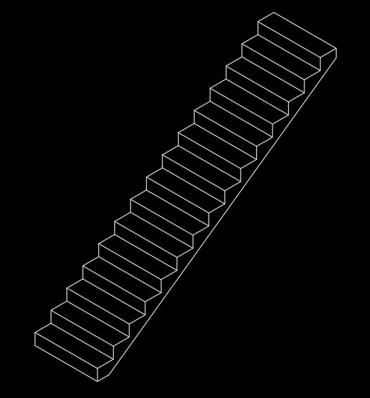

Here is an example of a very simple straight run of stairs drawn in a 2D isometric. The overall length is 14'-0 3/4". The overall height is 10'-0". The rise is 8" and the run (stair tread depth) is 11 1/4". The width of the stairs is 3'-0".

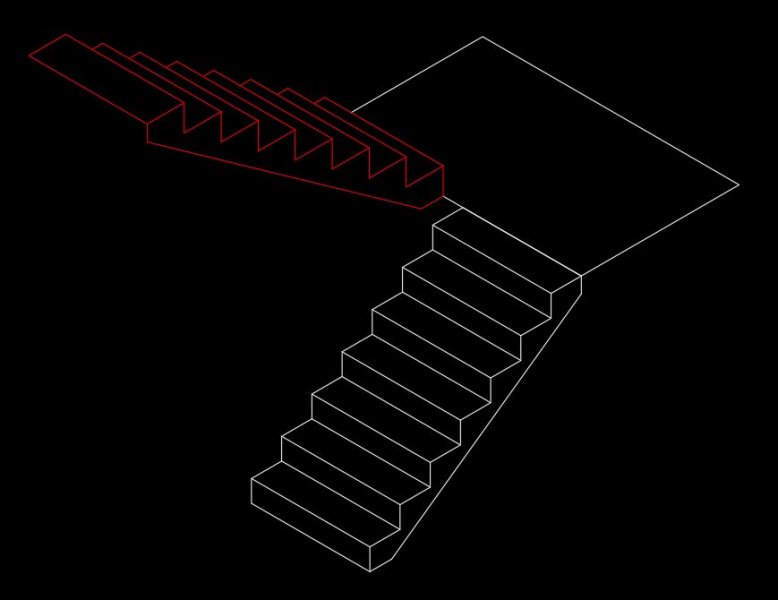

And here is an example of a very simple staircase that utilizes a landing so that the stairs can turn and go in the opposite direction. This version has the same number of steps (15) as the one posted above.
Local/national building codes will give you guidance re: max riser height, minimum tread depth, minimum width and minimum distance to any wall once one leaves the last step (important when dealing with landings). You'll also be made aware of minimum/maximum rail heights and spacing of balusters if they are to be incorporated into the stair design.
