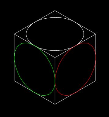

ReMark Posted January 23, 2017 Posted January 23, 2017 (edited) I wouldn't go that far. I've got a few more years experience and have worked in more different disciplines than you however. You're still a student so that is to be expected. I mentioned how to craw an isometric circle in a previous post. It is pretty straightforward. Just remember to use the correct isoplane. The image below shows a box with dimensions of 2x2x2. The three circles shown were drawn using the ELLIPSE command and its ISOCIRCLE option. The white isocircle was drawn using the Isoplane Top orientation. The red isocircle on the front of the box was drawn using the Isoplane Right orientation while the green isocircle on the side was drawn using the Isoplane Left orientation (the orientation of the crosshaits is changed via the F5 function key). All three isocircles have a radius of 1. What is not shown are the three temporary construction lines (one on each face) used to locate the center of each isocircle. I could have also used the command modifier named MTP or M2P to locate the center of an isocircle transparently during the execution of the Ellipse command when the user is prompted to "Specify center of isocircle:". Either way is acceptable. Edited January 23, 2017 by ReMark Quote

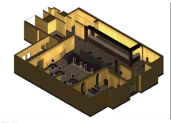

ReMark Posted January 24, 2017 Posted January 24, 2017 Check out this interior isometric view of a cafe by Emily Miller. This is a good example of what an interior designer should be capable of doing. Can you share with us the exact wording of the project assignment? I'd be curious as to how much leeway the student is given. Quote

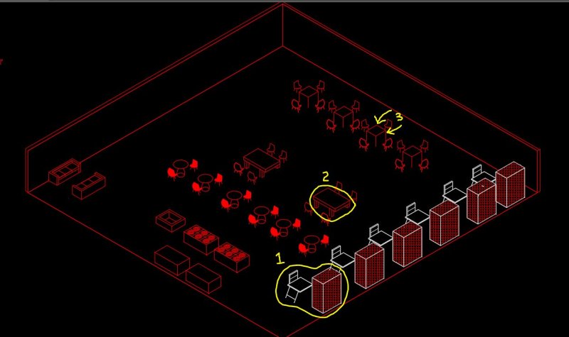

wonderpriya Posted January 25, 2017 Author Posted January 25, 2017 Yeah they are stove tops. Which rectangular objects? How do you control rotation in autocad. In the 2d isometric I'm trying to rotate the 4-seater tables along the plane of the floor so they will be aligned differently from the 6-seater tables but its rotating in the wrong plane. How do I do that? This is how it looks now. https://www.dropbox.com/s/2v8y6ezcjmuuqkb/intermediate.dwg?dl=0 Quote
ReMark Posted January 25, 2017 Posted January 25, 2017 (edited) "Which rectangular objects?" The ones that you applied a hatch pattern to. It appears each has a table and a single chair in front of it. "How do you control rotation in autocad." Normally via the Rotate command but since you are drawing a 2D isometric this won't work. You'll just have to redraw it to show the different orientation. I have some comments/questions regarding the objects shown below.... 1. These are the objects I previously asked you about. 2. These tables are incorrectly drawn. The legs are 7" square and too short and the tabletop is 8" thick. 3. These tables have legs and a tabletop that are just single lines. How thick is the tabletop? Are the legs round or square and what size are they? Even in a 2D isometric your objects should be drawn to real world sizes. Where are the walls surrounding the kitchen? Where are the wall surrounding the bathrooms? This is why I suggested drawing a fully developed floor plan first. It shouldn't have taken you more than four hours to do it given the simplicity of your design concept. By the way, some of your linework is sloppy. In several places lines overlap while in other places there are gaps. You also have overlapping objects where the object that is supposed to be in front does not block the view of a portion of the object that is behind it. This must always be taken into consideration when creating a 2D isometric. Also consider using layers to distinguish different features of your drawing. The walls of the building, most of the chairs and tables, and the stove tops are all the same color. There is no real distinction between different objects. Edited January 25, 2017 by ReMark Quote

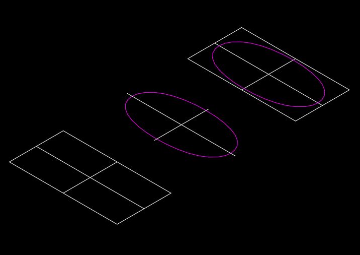

ReMark Posted January 25, 2017 Posted January 25, 2017 (edited) Re: isometric ellipse. For what you are doing I'd say the following method, given the accuracy of your drawing, would suffice. While in isometric mode draw a rectangle (do not use the Rectangle command to do this) using a single continuous polyline. Start the Pedit command and when prompted to select the polyline pick somewhere on the rectangle. From the list of options that appears on the command line choose Spline by typing the letter "S" at the command line then pressing the Enter key. The results should be similar to that shown below. It may take you a couple of tries to set the size you need but this method is the quickest and easiest one I know of. Edited January 25, 2017 by ReMark Quote
lrm Posted January 25, 2017 Posted January 25, 2017 ReMark, First off I want to commend you for the thorough and patient guidance you have provided wonderpriya. You have really gone up and beyond normal forum support. Many kudos to you. As for creating isometric “circles”, that is 2D ellipses for isometric drawings, I tried your pedit-polyline-spline approach and got the following. Note, I made sure the spline was closed. I think a better, and much easier approach is to create an ellipse with the Isocircle option with a diameter of 1.0. Then make two copies of the ellipse and rotate the first copy by 60° and the second copy by 240°. You can then copy and scale the ellipse by the value needed (the effective diameter) and place it where you want. As for reducing the file size and making the drawing more efficient, I would emphasize to the OP to use BLOCKS for the definition of furniture items. Whether a table or chair is a number of faces or a solid model using blocks is much more effective. Unlike groups, Blocks store the definition of an object only once. Therefore, each instance is low overhead as all that is stored for each instance is the location, scale and orientation of the block not its geometry. A drawing with 10 instances of a complex block will only be about 5% larger than a drawing with only 1 instance not 10 times larger. Not only will the file size be much smaller the user can make changes much easier. For example, if the style of a chair or other piece of furniture needs to be changed, the user only needs to redefine the block and all the instances are automatically updated. I am sure you understand this but I don’t think the OP is aware of the benefits of blocks. ~Lee Quote
ReMark Posted January 25, 2017 Posted January 25, 2017 Irm: Your kind words are much appreciated. I'm not sure what you did differently than I did but before posting the image above (as proof) I tested the suggested technique...twice. Your suggestion works just as well and will probably prove to be more accurate. The OP is encouraged to try both methods and choose what works best given his particular circumstances. As regards blocks I could not agree with you more. However, I think what the OP might have done is downloaded mesh blocks and from what I have seen these tend to have a much greater file size than a comparable block comprised of a solid. A combination of factors may have led to the 5MB+ file size the OP was dealing with originally and his lack of knowledge of 3D along with a tight deadline may have led him to make some hasty decisions regarding his approach to the project. Had he sought help sooner I think he may have had better results. Quote
